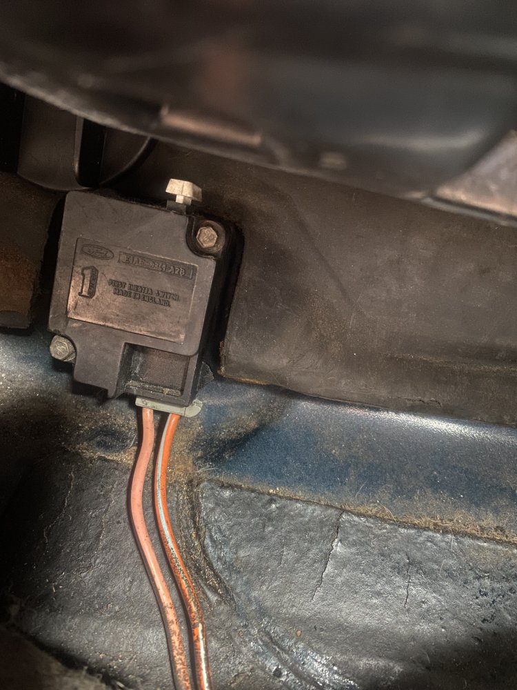

Question...im heading to the junkyard next week to pull some stuff for my B2.
One thing i need is an inertia switch.
Is there anyway to know if its any good before i buy it?
check it with an ohm meter, or battery & light bulb.
very low readings, like 0-1 it's a dead short between contacts inside.

Ok.
You know off hand what size the bolts are?
The ones on my ranger are long gone and the ones on rusty #1 are gone as well.
Id like to have this one actually bolted down and i dont wanna take more sockets then needed
I would have to look, on my 2005 it's like 8mm or 5/16 I think.
even the ones on my old Taurus's were small.
a 1/4 inch set should work.
I just checked the NAPA website and Echlin # ECH FPS100 fits just about every vehicle on the planet.
check around, might be many sources for the switch.

Alright.
As far as the bolts it seems 8 or 10 mm were right but i didnt remember for sure

Just looked at that napa one. Its got 3 prongs (mines 2) and is 80 bucks. It would pry work if i cant find a factory one somewhere.
6mm on my 87
