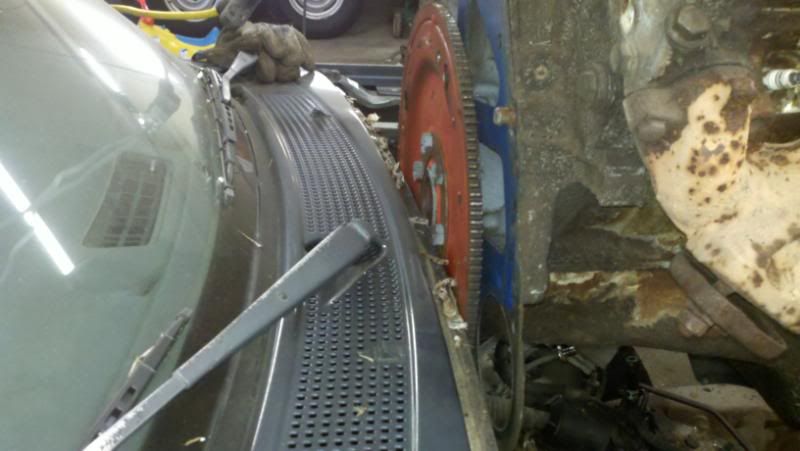

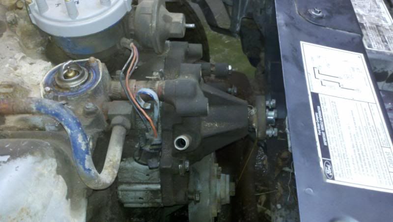

I'm finally get started on my '93 Ranger, and wanted to see how the motor would fit. Even though the motor has the wrong oil pan and isn't close to being ready, I still wanted to see how it looked in there...
I had this on one end...
And this on the other end...
So I was able to twist the motor about 45*, pointing the flexplate toward the passenger seat and the harmonic balancer toward the driver side headlight, and without any trouble at all was able to lower the motor in without hacking the core support...
Looking good! Just a pinch here and there! LOL I can't wait to send my 289 to the machine shop! I'm gonna do the 3" inch body lift before I put mine it to help out for clearance. What year is that 302?
I'm not for sure of the year, somewhere early 70's... and it's a 460 :3gears:
D0VE-A block and D0VE-C heads
yeah, that's a big intake manifold for a 302!! another tell is that short, straight water bypass hose.

That would explain why it would'nt fit at first!:icon_rofl: I just glanced at it. Holy Hell!:shok: That's gonna kick ass when you get it to fit!:icon_thumby:

That goofed me up to, I blame his name.
I couldn't beleive how huge it was in there, the thermostat/water pump didn't look like anything I had seen a 302.

All things considered it doesn't really fit that bad. :icon_thumby:
x2 i was like dam thats a tight fit, and the biggest 5.0 ive ever seen lol

lol its easy to tell its a big block, you could probably fit a 302 between the valve covers of those engines lol.. thats going to be nasty!!
There's more room in there than I was expecting, but it fills up quick when things start getting put in place.
