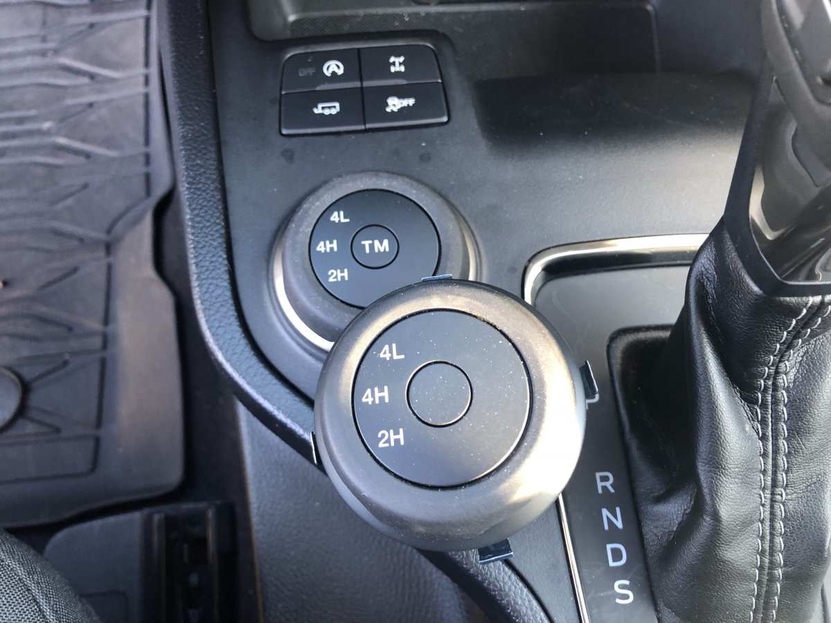

I received the rotary switch with the terrain management button two weeks ago. I used FORScan to enable the off-road gauges and terrain management modes. the whole thing took about 5 min.

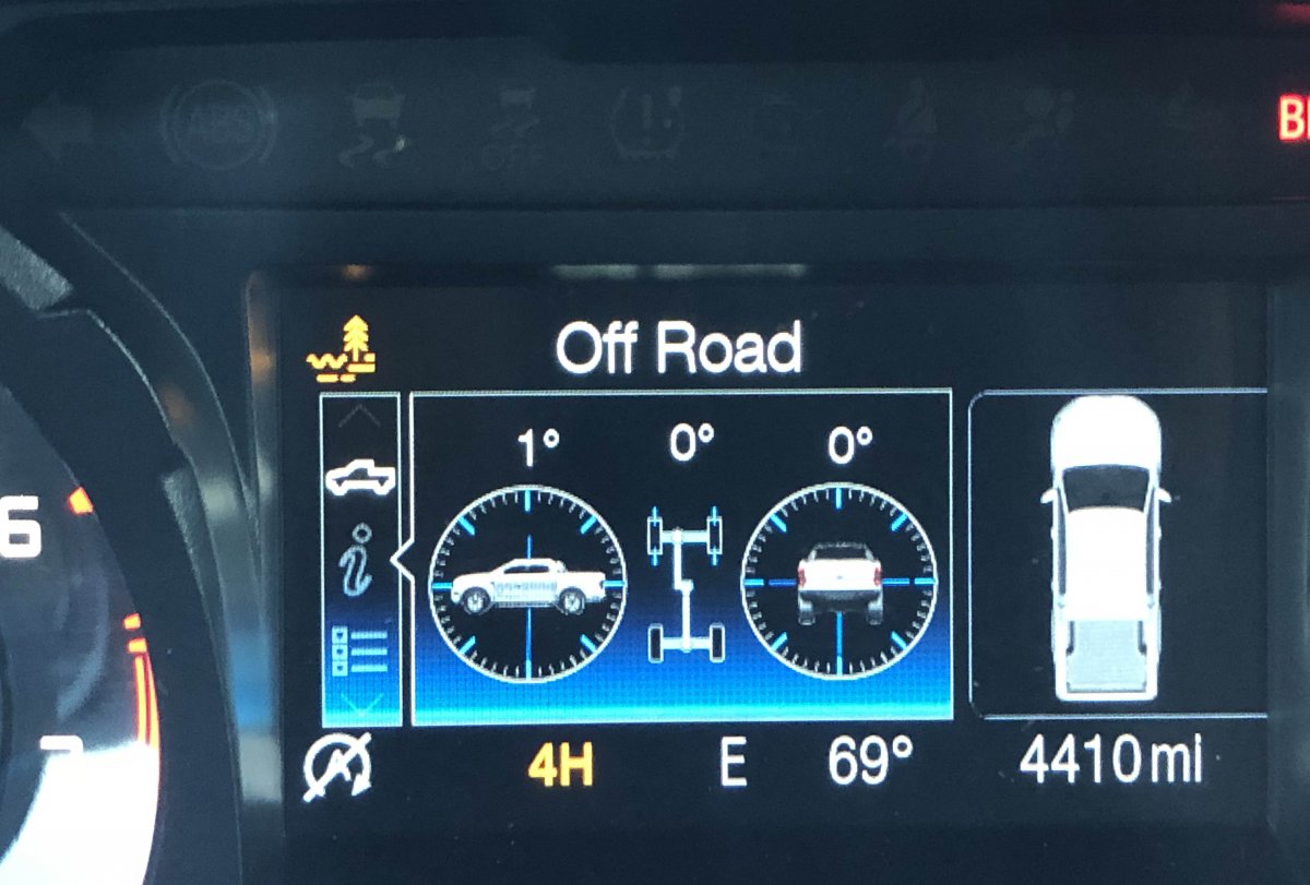

Here is what the gauges look like. This is a showroom stock 2021 XLT Sport 4X4 with the tow package.

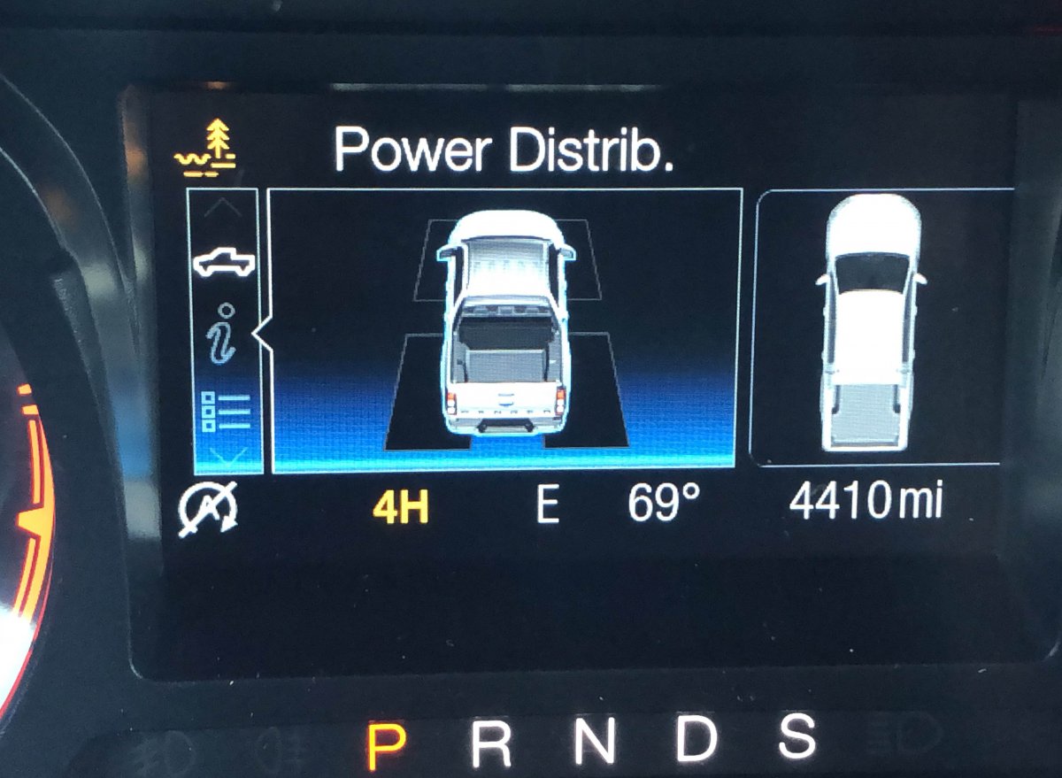

That looks pretty much like mine. I don’t remember the power distribution display though. It could be I didn’t mess with it enough to run across it or it wasn’t part of the package in 2019.

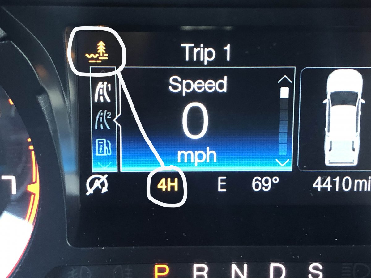

From the TRUCK INFO you get the PITCH/STEERING/TILT screen Hit the arrow down on the left side of the steering wheel.
The POWER DISTRIBUTION has blue boxes under the tires that show where the power is going. In 4WD you get a box under each tire, in 2WD you get a box under the rear tires only.

LOL, but technically it's just pushing a button. You only need to turn the dial to get to 4L. And when you turn the dial be sure you've got your fun-o-meter set to the European scale.

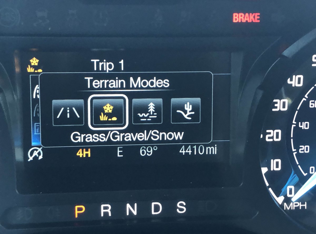

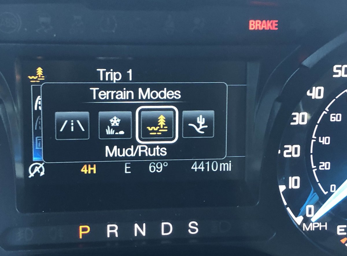

Mine seemed to shift to the desired mode when the terrain type was selected. All I needed to do was engage the rear locker.
Snow set it to 4 HI and I “remember” it going to 4 LO with mud. It is possible I’m misremembering that...
