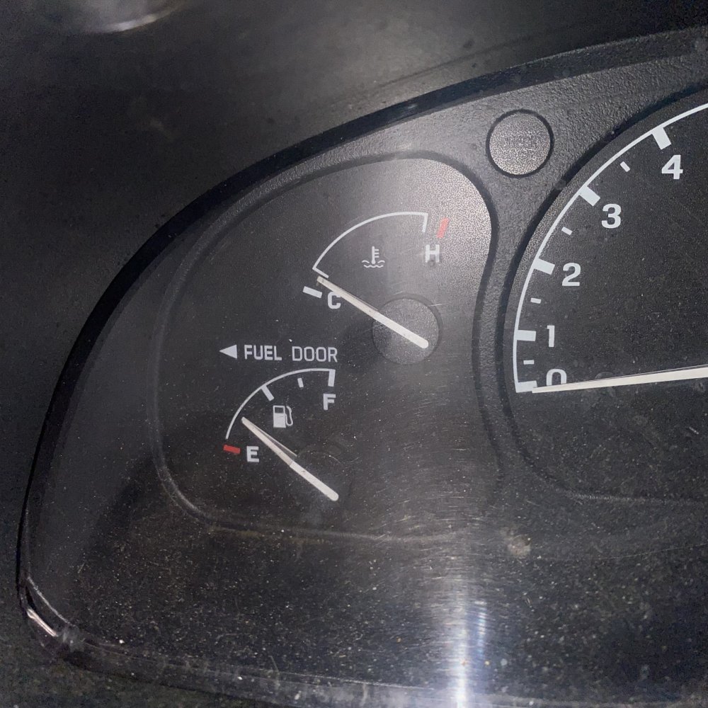

Decided to replace the thermostat and broke the brittle other temp sensor so… replaced the second sensor with the new one and put the original old gauge sender back. Now the gauge actually shows signs of life. This is the first reading Ive had since Ive owned it for ~5 yrs. Usually it’s dead below the lowest hash mark. This is after driving for ~25 min. I’m guessing the two pin ‘old’ sender might have come to life with the addition of the second ground wire. From what Ive been reading the temp reading could be accurate. It just seems so low from what Im used to in my other cars.
Any ideas?
Thank you.

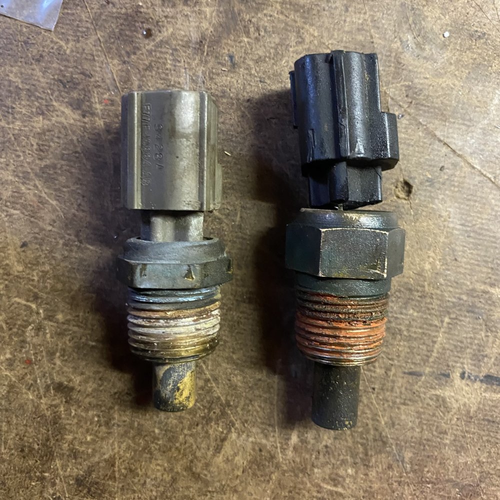

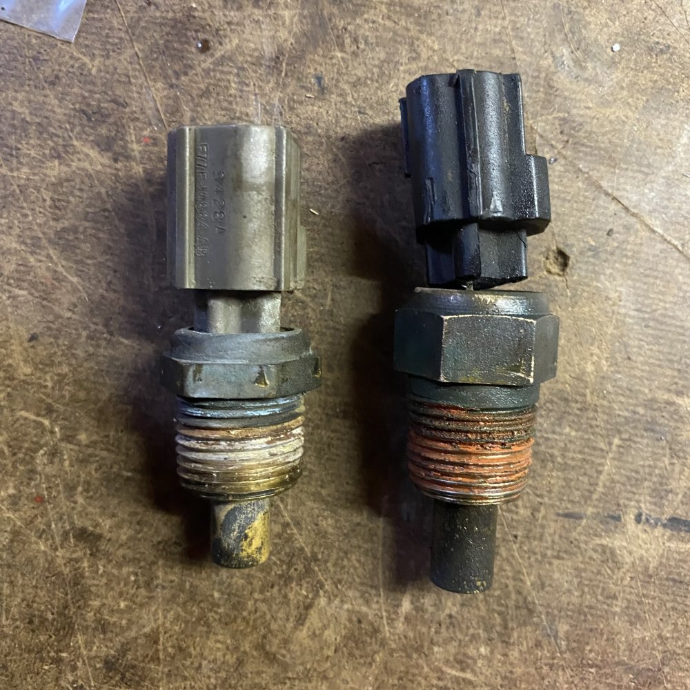

<edit> Ron I saw your comments on another forum re this same issue. You mentioned the shapes and different voltages of the resistors in the sender vs the sensor. Maybe Im confised here too. I’m attaching a pic of the two parts that were in my truck since I bought it. The new sensors I see have the cone which mine does not. The black ‘sensor’ does not have a part number the gray ‘sender’ does. I have ordered the correct gray sender by part number. TIA

Would you look at that. Replaced the sender with the correct part number and it works. Thanks to RonD for helping me realize someone had put a two pin sender in there and the solution was to add a second wire for ground. I appreciate your help Ron and the forum always. Now on to the next thing.

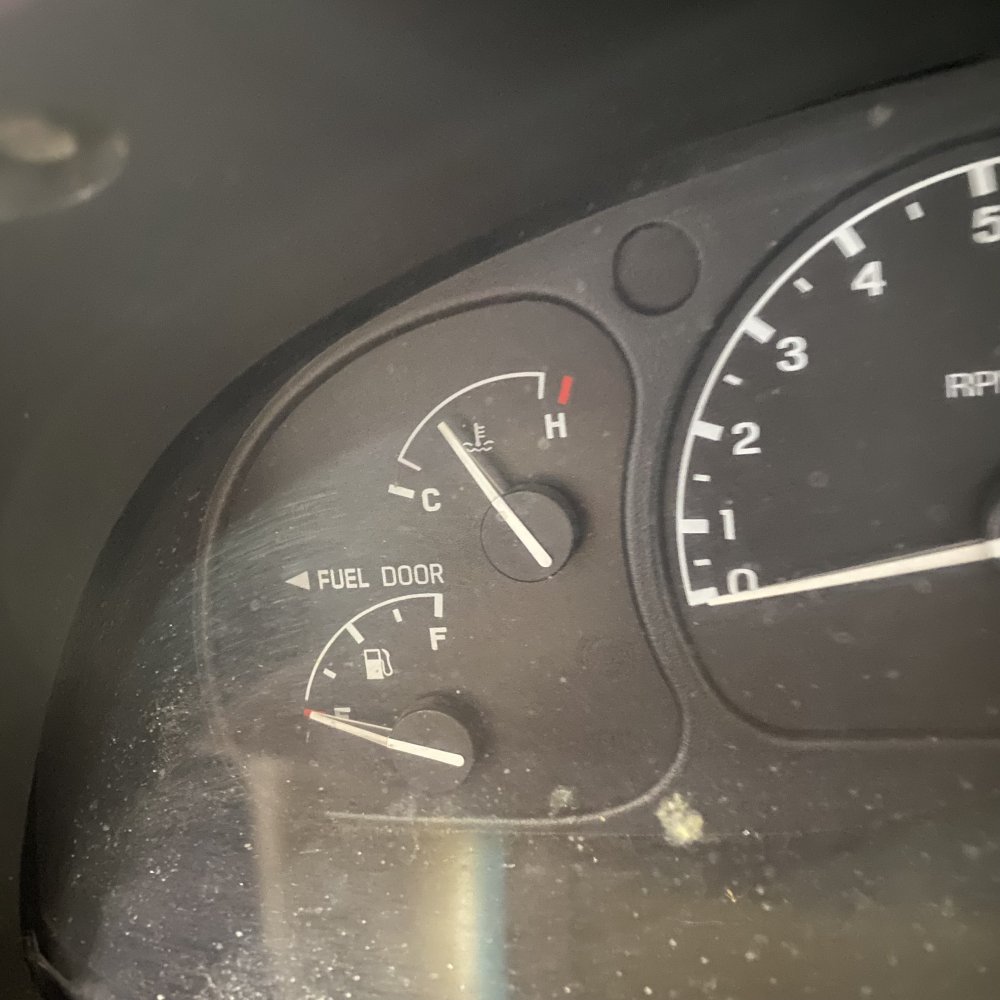

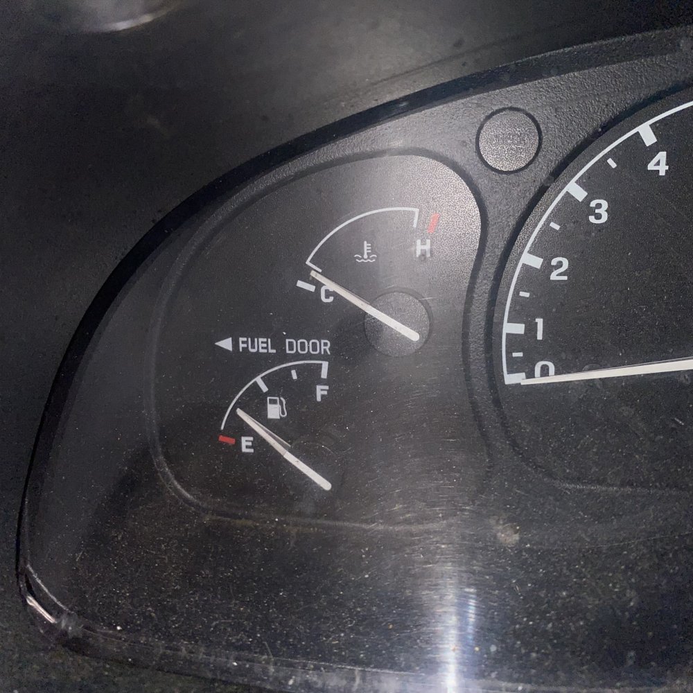

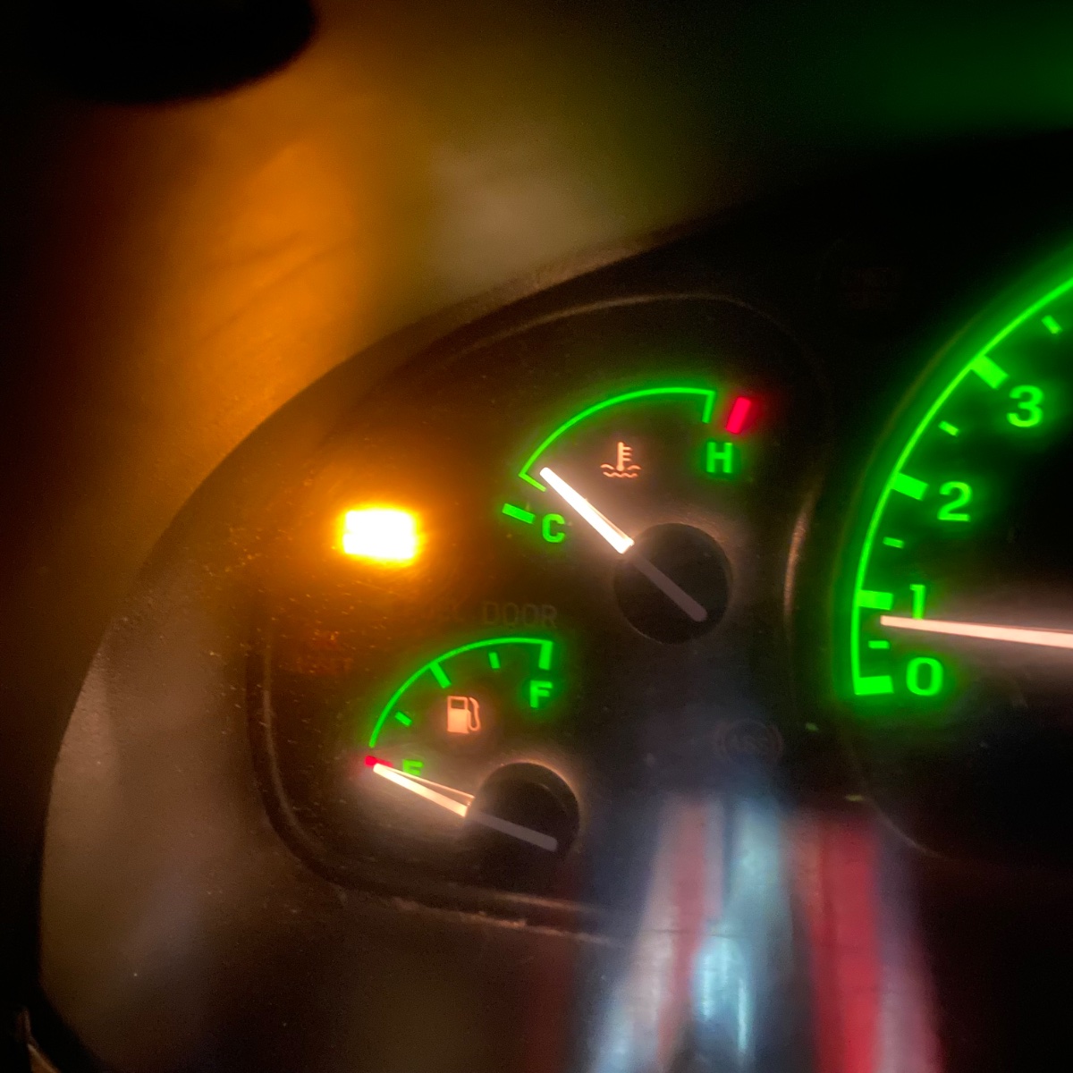

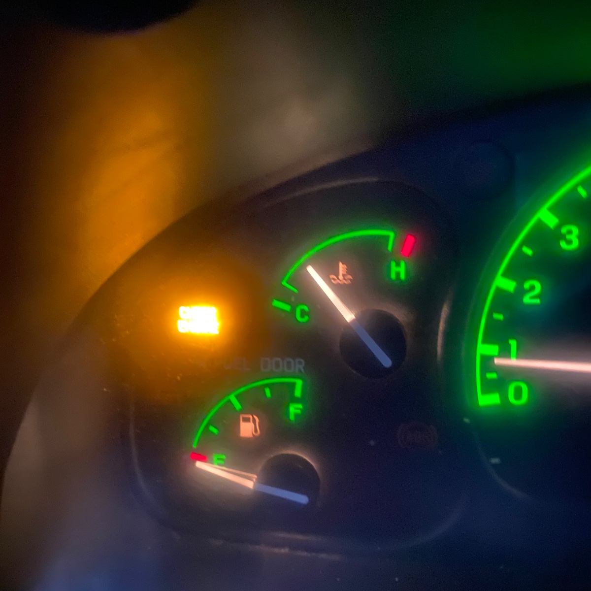

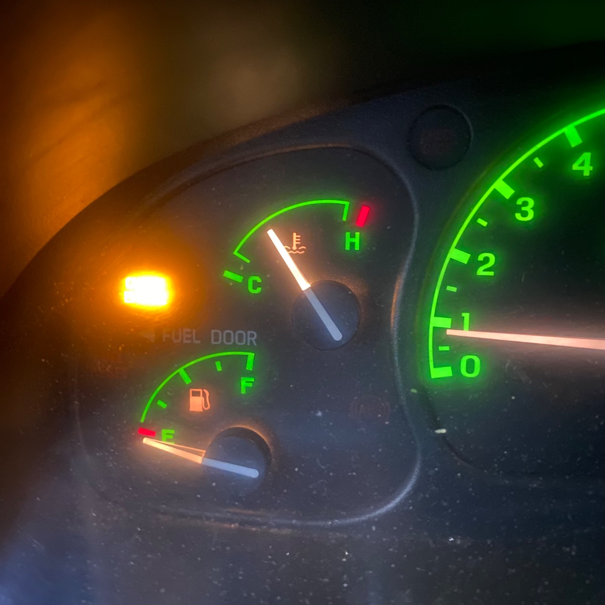

I’m back with a new temp gauge issue. Recently my gauge wont rise above ~1/4 and usually stays near the low mark. I retested the gauge as per RonD in 2024 and get good gauge and wire so I replaced the temp sender. Just went for a test drive and it hasn’t changed. Should I be thinking thermostat, water pump or maybe radiator? I blew a head gasket from over heating on another Ranger so I want to be ahead of this issue.

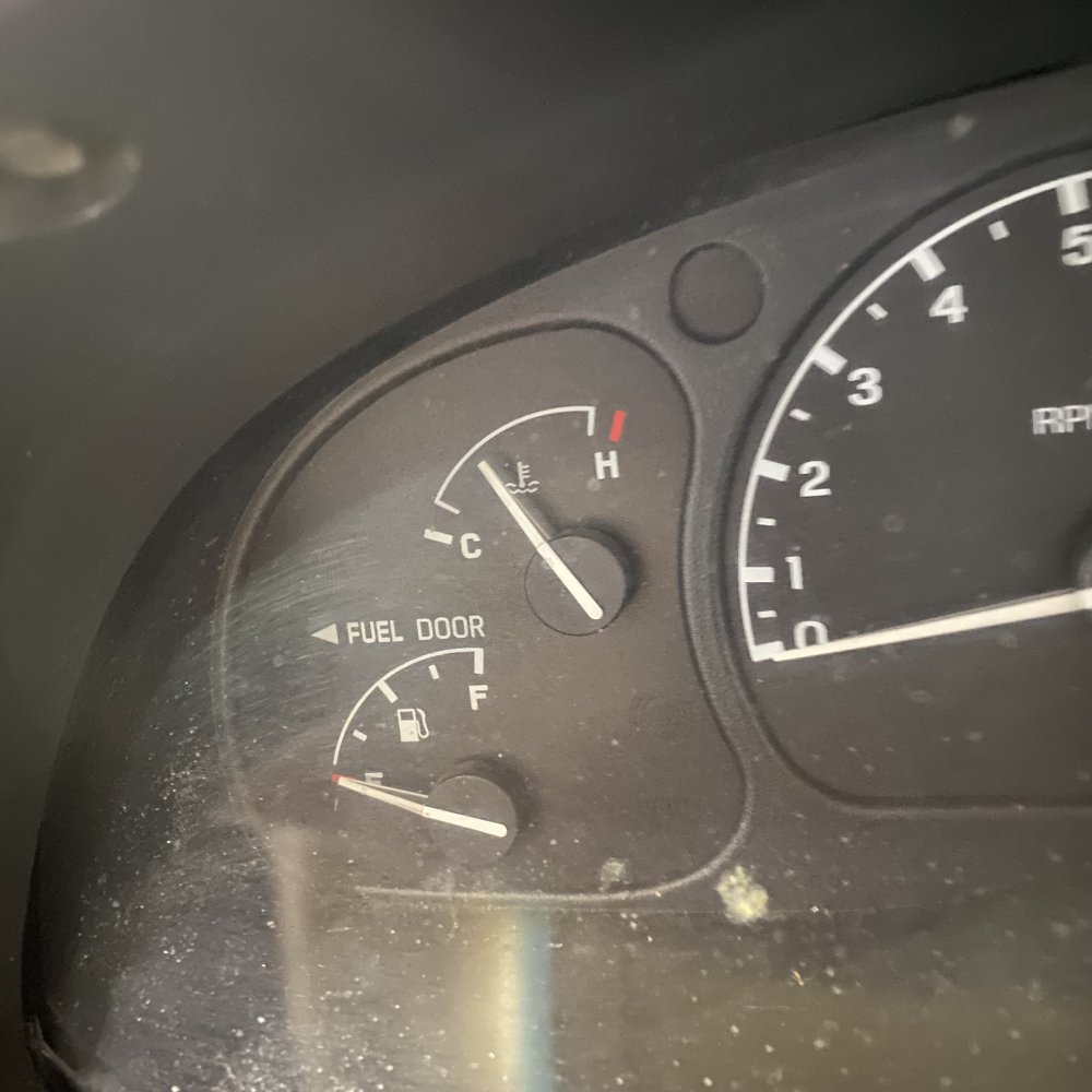

The first pic was highway speed, 65° out. The second pic is stop n go street driving and the third pic is idling in a drive-thru. Streets on the trip home back to pic 2. My ‘normal’ that I finally found in 2024 is just about dead center at all times. Opinions? Ron? TIA.
Add: radiator full, overflow almost half full and heat works. A quick search points toward a stuck thermostat. Replaced in 2024 but maybe?

Stuck is a possibility. So is a bubble right where the sensor is. Do you have a scanner to read the ECT from the PCM? It should be a separate sender. That might lend some direction to the search.

I do have a scanner. Thanks for the suggestion.
I recently had a stuck thermostat in my 98. But it resulted in the engine running too hot and the needle on the gauge going high. Is it possible for a thermostat to be stuck open, and cause the engine to run so cold the gauge won't move?
Supposedly thermostats are designed to fail open. That hasn't been my experience though.
Same here. The old one wasn’t stuck open but apparently it was bad. The new one put me back to normal.
