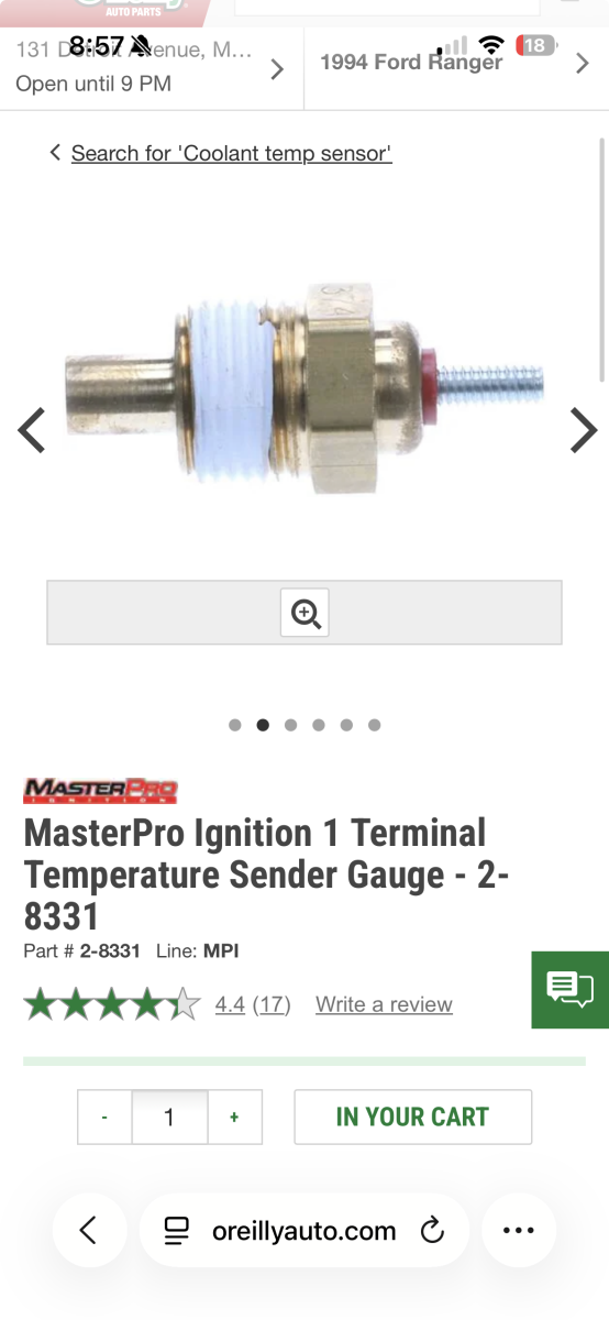

Hello yall as you may know I had a motor put in my truck a few weeks Ago and this week I noticed my temp gauge won’t work right, the heat blows hot and stuff but the gauge never gets to the normal Range? The thermostate is new so it shouldn’t be that but I guess it could, but went I’m like on it an accelerating the needle goes down significantly then it might creep up after a bit again but then go back down again after driving at a steady mph for a bit. I went to o Riley’s but think I got the wrong part I got a temp sender but I think I needed a temp sensor?
Temp gauge
That should be the right one. The older trucks had two. The single terminal one is for the dash gauge, the one with two terminals is for the ECM.

Well now I’m curious what goes bad in these? There literally a stud
They can really only go open or short. They just provide resistance to ground. The resistance changes with temperature to make the gauge move. You can force the gauge to one direction by grounding the wire. I think there is actually a chart floating round the 'net of resistance relative to temperature somewhere.

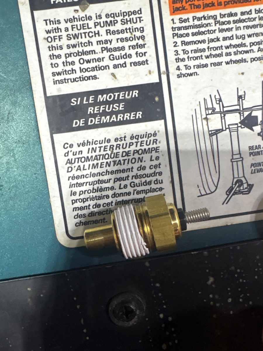

well i can see why they would say that it would kind of insulate it from the block but whenever you screw it down its going to make a good connection

teflon causing a bad ground is why i think they say not to use it
but i think it would just, for lack of a better word, "bite through the teflon"

So leave a portion of the sensor not covered with tape, then your sure to have a ground and still seal.

Ok, do these things not go in flush I took the old one out not noticing if it was flush put the new one it it only went on half way well maybe a little more and then it stopped so I cleaned the old one up and reinstalled it, it didnt sit flush also didn’t work still check engine light came on again an gauge didn’t work right, so I’ll put the new one on tomarrow
