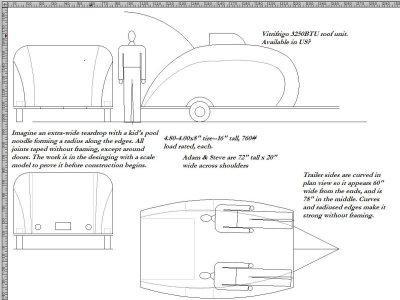

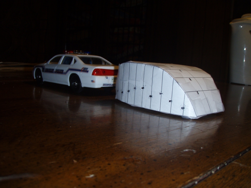

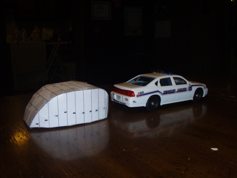

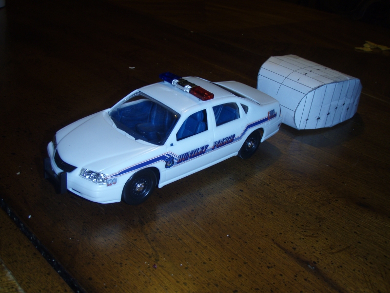

I know a couple of people that want to build one. They asked my opinion and I opinioned that they are too small. I designed one a little bigger, and built a scale model from paper that looks promising.
Here is what I've done so far. You can print out those pdf files and make your own model. We're planning to build it mostly without a frame to save weight--wire it together and fiberglass tape the seams.

Plywood is what we're planning to use. Probably 1/4".
