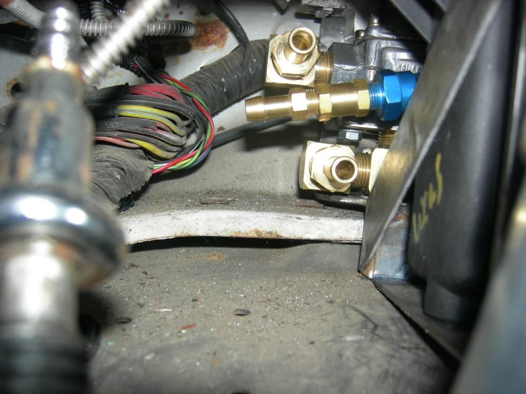

And these are the fuel connections for the fuel pressure regulator. From bottom to top: supply from tank, return to tank, supply to filter.

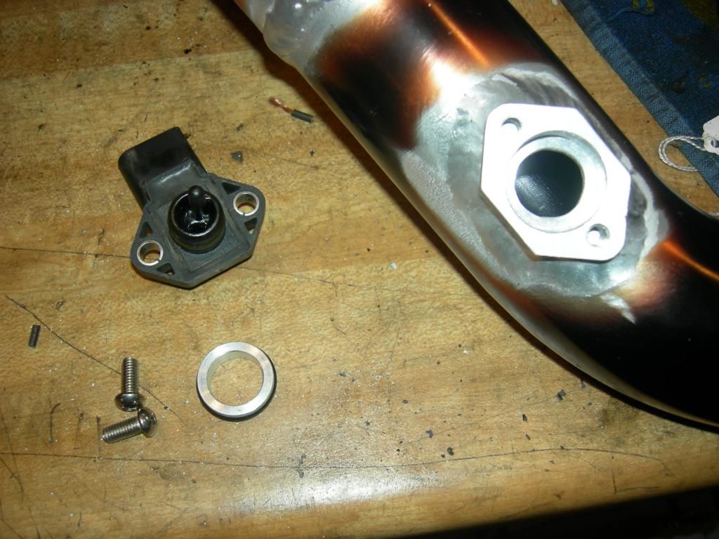

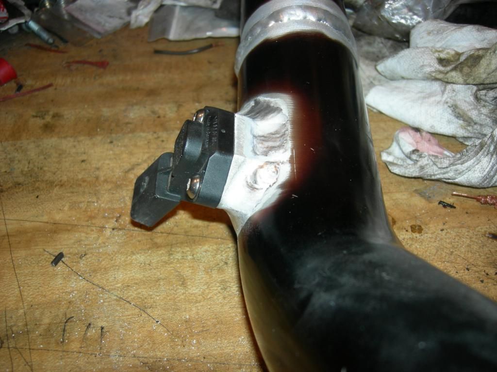

Charge Air Pipes, cont'd
I still had to open up the holes for the MAP and the CCV before I could throw some paint on the pipes. Here's some detail of my ebay MAP bung kit if you haven't seen one of these before:

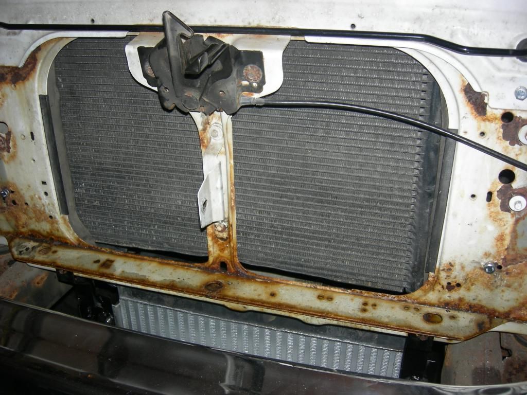

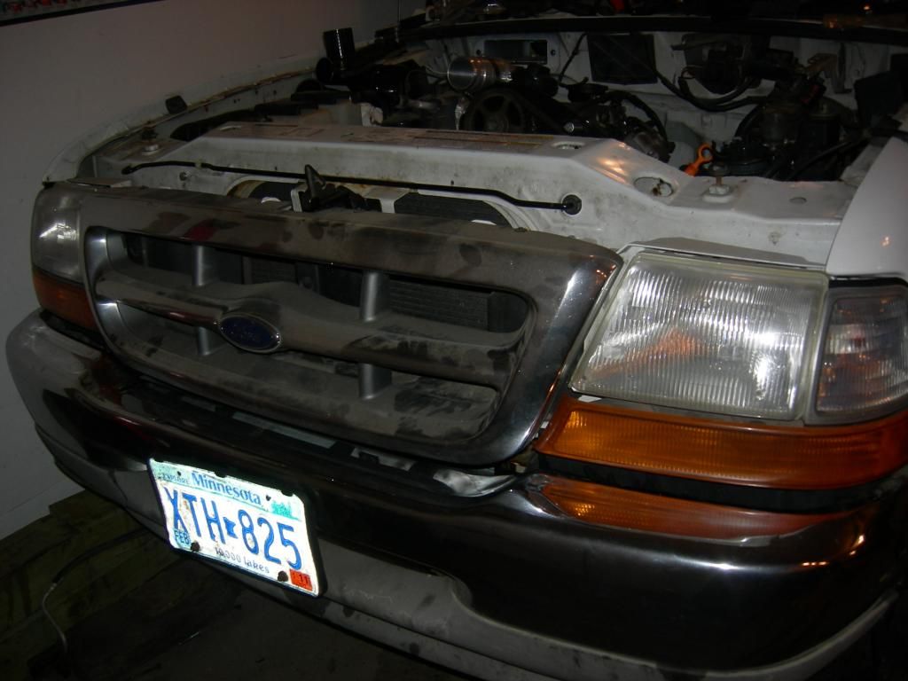

Cooling System, part 3
I finally got around to painting the radiator and intercooler brackets. With these finished I was able to unwrap them and do my final install.
