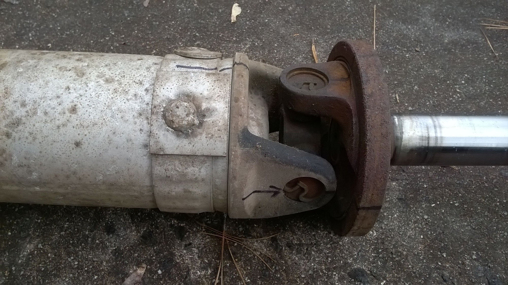

Some vehicles may also have the yoke with a large balancer on it, similar to this:

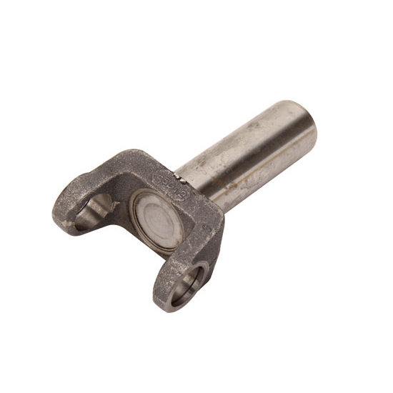

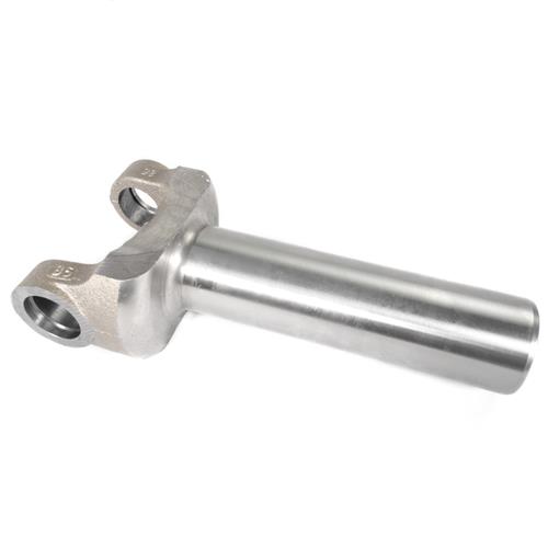

Here's some links that I had saved from my swap, many that have measurements listed, but be sure to check those u-joint numbers before buying. This should also give you some insight in to which vehicles came with those yokes, but again, some may have different series of u-joints than you plan to run.
Just be sure it's for the size of u-joints you're gonna run before buying one. They are available in different u-joint series for various swaps, etc..
