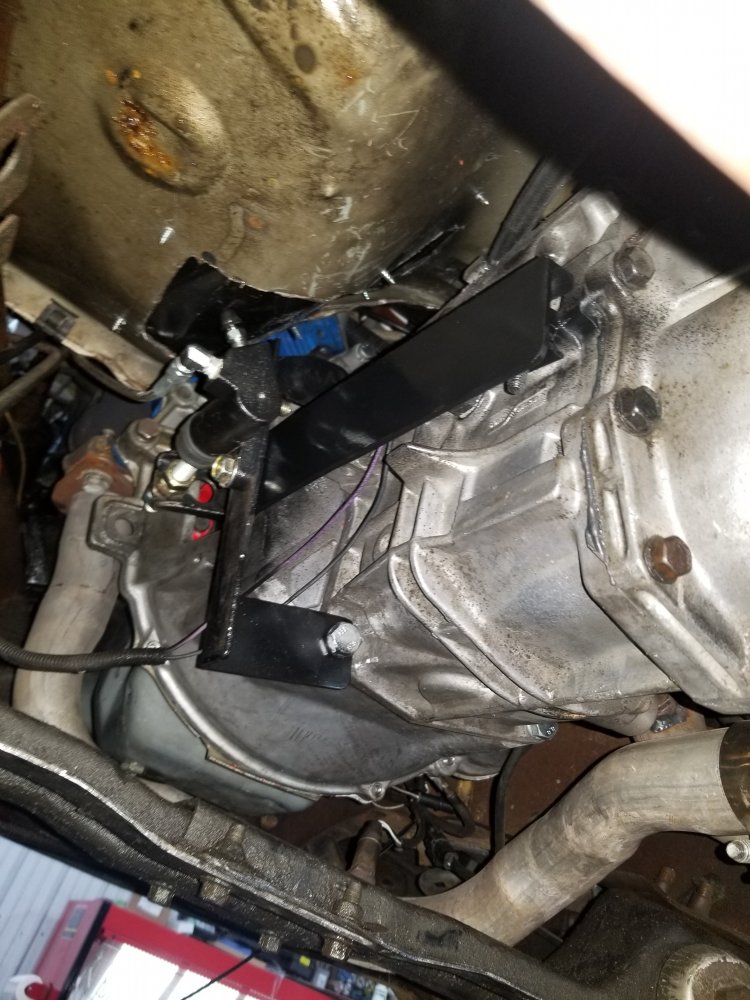

T5 and an attempt to stay hydraulic.
Rather not do that. Do you happen to have a pic of your clutch line if its finished?
43901
Oh chit..glad I asked!! So you have enough room and its not to tight?
Hows it working out for ya?
Just fine. I would order a 22 inch if you are worried. Your bracket/slave may require a longer line depending on where its mounted and the angle of the inlet.
