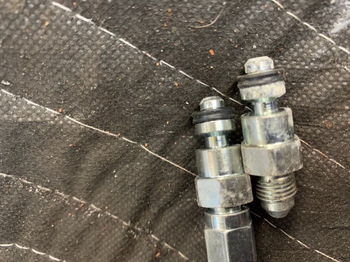

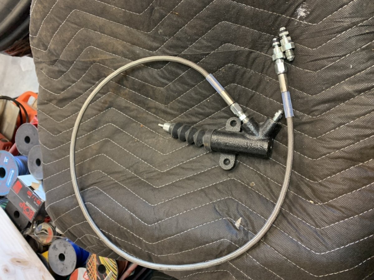

This is the type of setup you can use if going t5 using the stock ranger master cylinder
