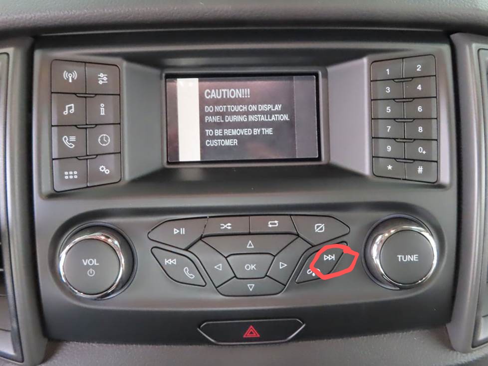

Do you have the base radio or the one with the big 6" screen?

If you have the base radio, the FF button is circled in red.
I have the base radio and I tried the soft reboot with the button you circled. I pressed the on/off button and the ff buttot the same time. It was supposed to go dark and then the Ford logo would come up. Didn’t work. It is a new truck and might go to the local Ford dealer. Thanks for your help.
