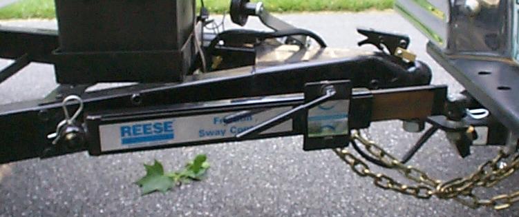

I agree... we pull all the time with a f150, just with good tires on the rear, sway bar, and leveler system. sometimes we use the sway bar... i've seen some people use 2 sway bars. I'm talking about these
sway control question...
which is the friction deal yall are talking about. we don't always use that thing... it's more annoying than worth it sometimes.
Yeah thats basically what i got. Other then the fact it makes it kinda hard to turn on wet ashphalt and makes alot of noise in the rain it works really well. ALOT less scary then nothing at all.
