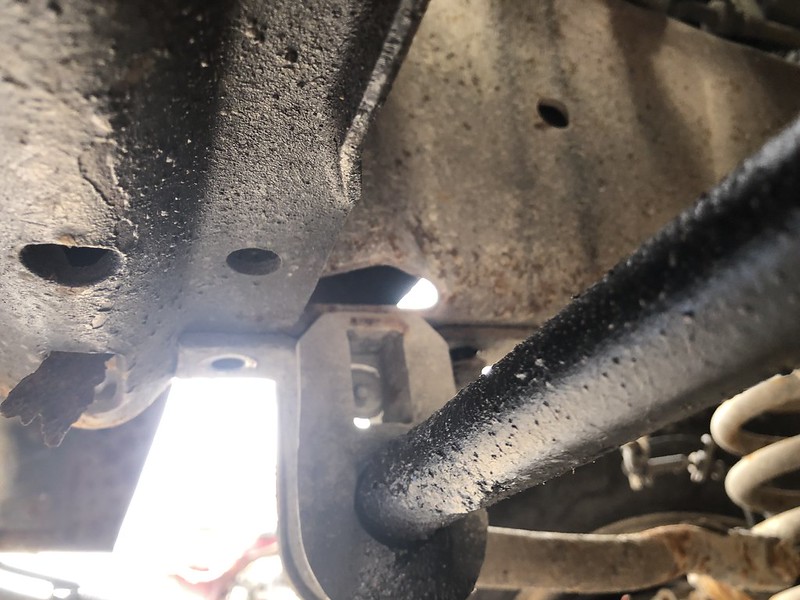

Does the front sway bar mount plate go over that pointed stud facing downward on the frame rail? Kind of a locating dowel?
The change in the way the forward located sway bar mounts to the frame occurred in 1992 when the crumple zone frame rails were introduced. Before '92 they bolted to those plates which were then bolted to the frame. '92+ bolted directly to the frame.

I went to the back field and checked my BII's today. I see what you mean about the plates that the sway bar mounts to. Only one problem. My 87 2wd truck doesn't have any holes in the bottom of the frame to mount anything in front of the beams. There's one hole and that's it. Unless I unbolt the curvy front crossmember, but it seems way too far forward.
So it looks like I'll be drilling holes in the bottom of the frame rail and possibly welding nuts to the frame over the holes. I'll find a solution in the end I guess.
I'll have to get the plates pulled from my 89 BII (easiest one, with no engine in it) and get under my 87 2wd and see what everything looks like.

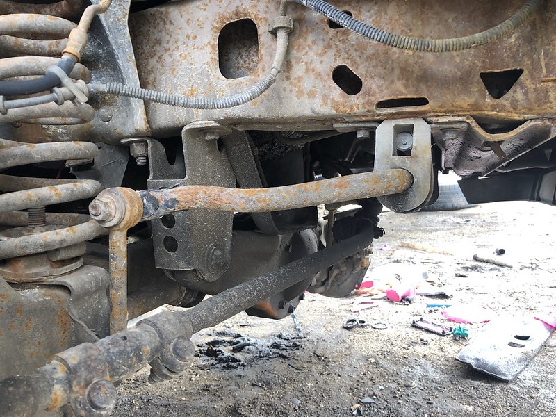

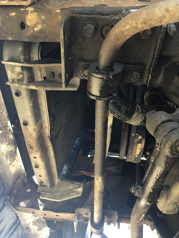

For anyone wondering...
Early sway bar ahead of axle with plates: (note braces that run up to frame rail too)
Later style that bolts on the frame:
