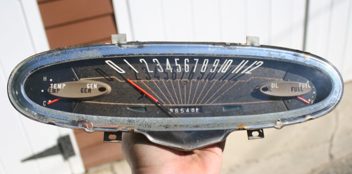

2006 2.3l still has a TEMP SENDER, it was behind the head on a metal coolant hose, that should work for the 1961 dash temp gauge
Red/white wire to cluster, black/white wire is ground
Not familiar with Rambler tech and what OHMs the temp gauge expects, but worst case is you would swap current one with Rambler model
Rambler just had an Oil Light, 2.3l just has an oil pressure switch, so that should work out, lol
Ranger oil pressure switch is normally OPEN, you will want to change that switch to a normally CLOSED oil pressure switch to use it with a light bulb
OIL Light bulb gets 12volts with key on, and its GROUNDED by the normally CLOSED oil switch, OIL light bulb is on
When you start the engine oil pressure pushes OPEN the switch, light bulb off
Rambler has a GEN(generator) light and that should work out as well with simple rewire

RonD -- thanks for all that info! AMC (Rambler) used the same type gauges and ohm ranges as Ford did for the earlier cars (60s-70s). Old Stewart Warner standard of 73 ohms empty/low, 9 ohms full/high. The specs may vary slightly (+/- 2-3 ohms on each end), but they are the same range. Currently the car has a 15 gallon fuel cell (minus the foam) that the previous owner installed. What he did right was mount it under the trunk floor with straps like the original tank. What he did wrong was just cut a 8" circle in the middle of the floor to access the top cap and use that as the filler. No fuel level sender. So I'm going to put a plate over the floor hole and install a fuel level sender and a neck to attach a hose to the original fill location. The big hole in top will allow me to mount a screw on neck (flanged) to the side of the plastic tank with a gasket. I'll either do that or get another tank.
Pic of Rambler gauge cluster. The face that shows is roughly 3" tall by 12" wide.
