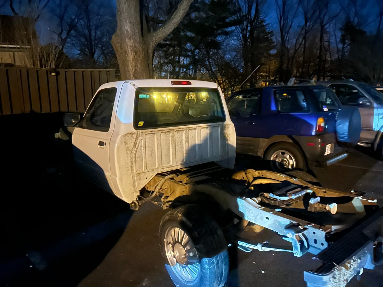

Here's my nice clean 2006 cab. It came with a good 2.3, a shot auto trans, and a frame that's frankly nicer than mine (no frame swaps, I say to myself, I need to keep this project under control). It didn't come with a key, though. I plan to swap over all the wiring from my old cab to this one. Fortunately besides the auto trans, all the equipment is pretty much the same between the two- manual locks and windows and 2wd. Looks like my old wiring should just drop in. I'll be keeping the 06 dashboard itself since it's grey and I like that better than my beat up tan one.
A couple questions. I like the 06 steering wheel more than the old one; would it be feasible to keep it considering the differing airbag systems? Also, seeing as I will be swapping over all electronic systems, I assume the key and cylinder from my old column will be reused and I won't need or be able to use the 06 lock cylinder? I ask because the door and ignition locks would be mismatched and I'd rather keep them the same and get a new key from a locksmith.
