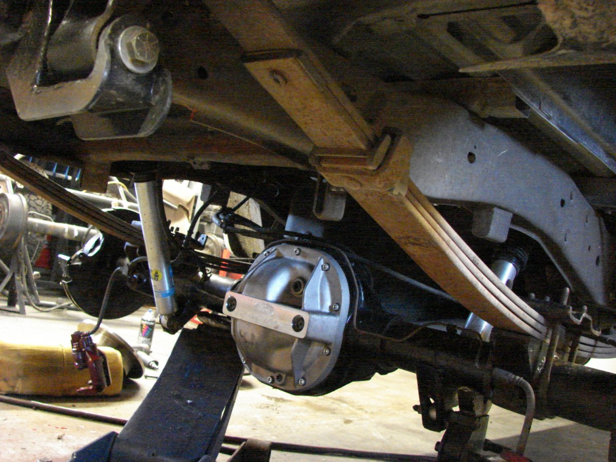

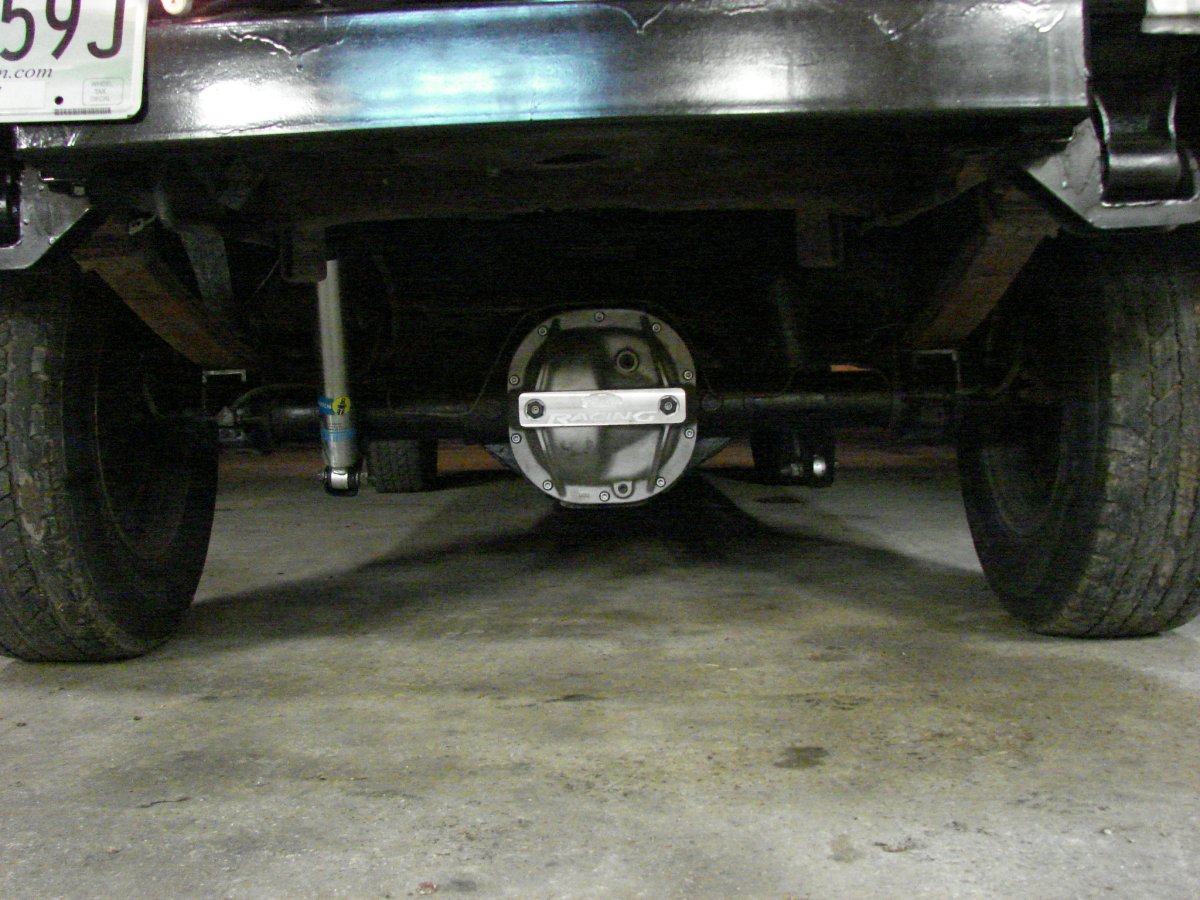

Thanks lil blue ford.. I bought a 90-92 8.8 because it is narrower than the 93 and up. My truck was a 7.5/9in 4 cyl originally, so i just bolted my 9 inch brakes to the 90-92 housing i bought. I didnt know what brakes were on it. All's I know is what I would like to do. It has a spool, and 35 spline axles now so no c clips to remove. it comes apart like a ford 8 or 9 inch

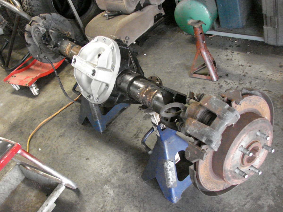

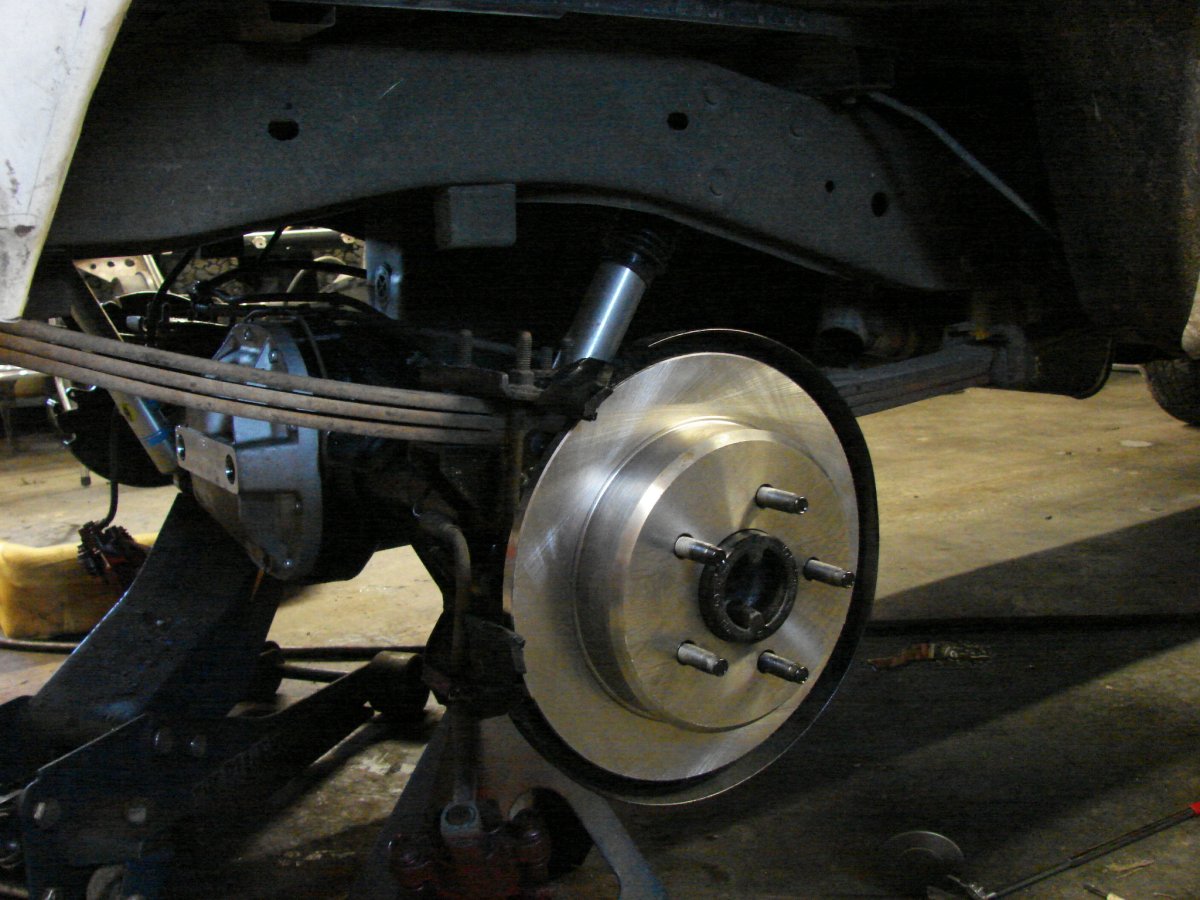

I thought about that and am still on the fence, the 98 Orange/white,and blue prerunner truck has the conversion. Idid it when switching to an 8.8 from a 7.5 ,Just not sure the discs would hold the starting line as well as drum for a foot brake bracket drag truck
