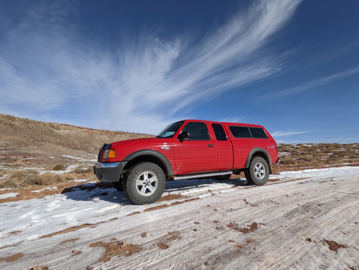

I ended up raising the front about 1.75" by cranking the passenger side key and replacing the driver-side key. Now both adjusters are near their mid-point of travel and the truck sits level side-to-side. I also added about 1" of lift to the rear with extended shackles. The rear still has tons of droop with the standard Bilstein shocks. I will say the ride and handling were greatly improved just with lifting the front end a bit and leveling it side to side (it was off by about 3/4" L-R, now I have it about 1/8" higher on the driver side). The new shocks further improved on the handling and I'll be taking it in for an alignment after I replaced the fixed upper control arm bolts with the new caster/camber bolts.
What an improved ride.
