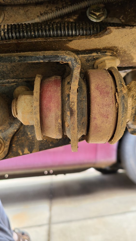

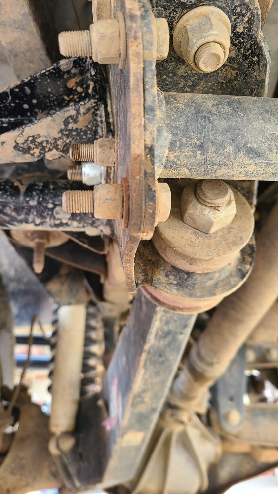

On my Skyjacker lift, I recently noticed that I have bent the driver side radius arm bracket. The part that the arm mounts through is pushed back, as if from a hard frontal impact and the rest of the bracket is slightly bent or twisted. If/when it gets worse, I plan to put a heim joint on the end of the radius arm and rebuild the bracket with a double shear design. That should hold it. Not sure if anyone else has seen this issue.
I haven't myself,
Got any pics?

I’ll take some this weekend.
These might show the bend. It's hard to get a good picture down there. Almost need to hold a straight edge against the parts to show how they are bent.
This shows the bent part where the radius arm attaches.
Here you can see the bend in the vertical side piece, just forward of the crossbeam.

Interesting pics Eric. That is the first time I've seen that happen. I would agree by the looks of it, was from an impact to the left front tire, or maybe having struck an object with the front differential (rock, tree stump, etc.) would do it too.
Looks like it should be fairly easy to hammer that back straight (and/or clamping it in a vise to straighten), and put a couple gussets on there (I see a crack near the bottom also, maybe just the powdercoat?)
Yes. That's just powdercoat flaking off. If I ever take that bracket off, it will be to completely re-engineer it. Not to hammer it straight. If I do more wheeling like what I did this past Friday, more stuff is going to be bending and breaking. I got a taste of something fun and I'm definitely hooked.
