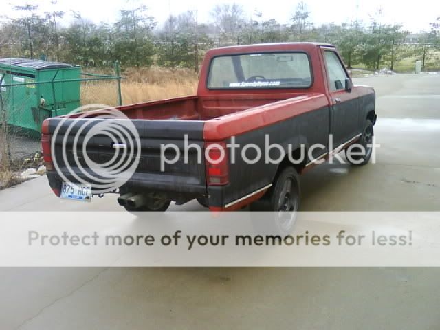

can i suggest a paint scheme? why not do it like 84 stealth ranger did. lower half in bed liner and upper half normal paint.
he did his red/black. u could do yours blue/black.
that would be cool imo.

All suggestions are welcome. How far up did 84 stealth ranger go with the bedliner? Up to the first body line? Or truly half way up so that the split is not on body line at all (my Explorer is somewhat like this)?
Ah, I see what you're talking about now. His truck looks pretty good like that!

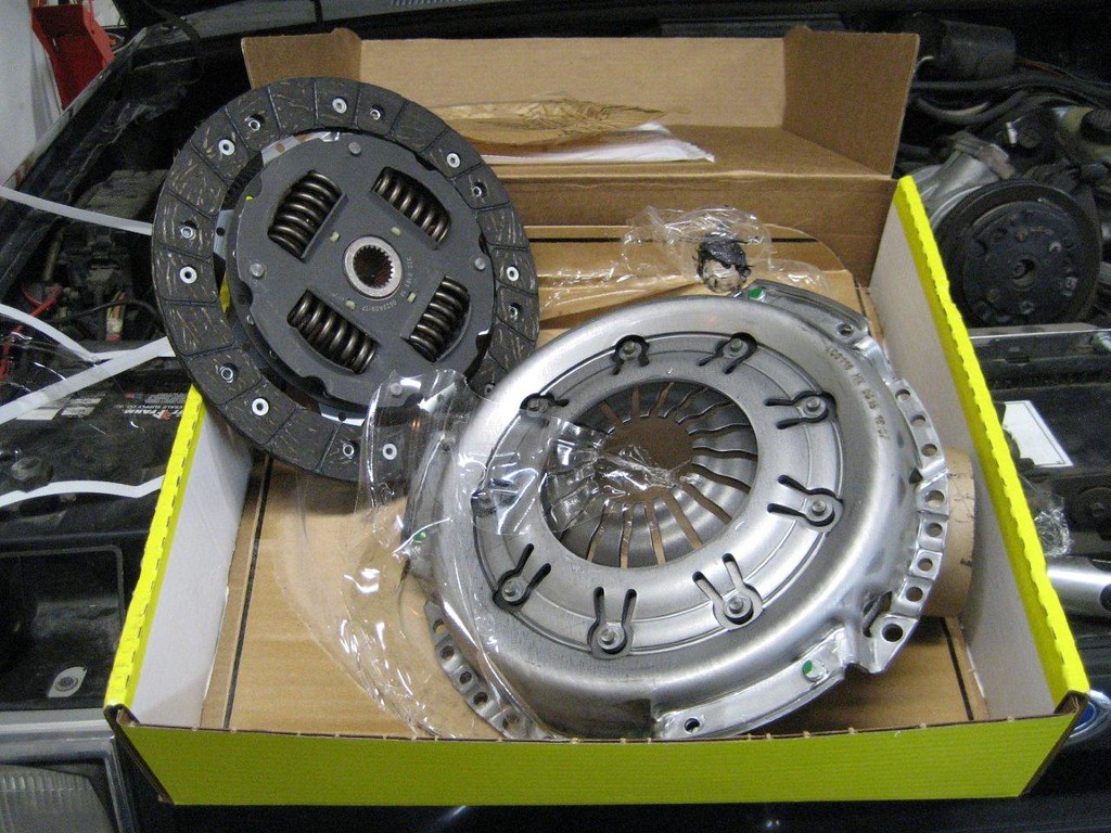

So out comes the Tcase, again, and tranny to replace the clutch and slave. I took the time to upgrade to a Luk 10" clutch for a 4.0. I have to say, it's an awesome upgrade, I only have a couple hundred miles on it but it feels really good so far.

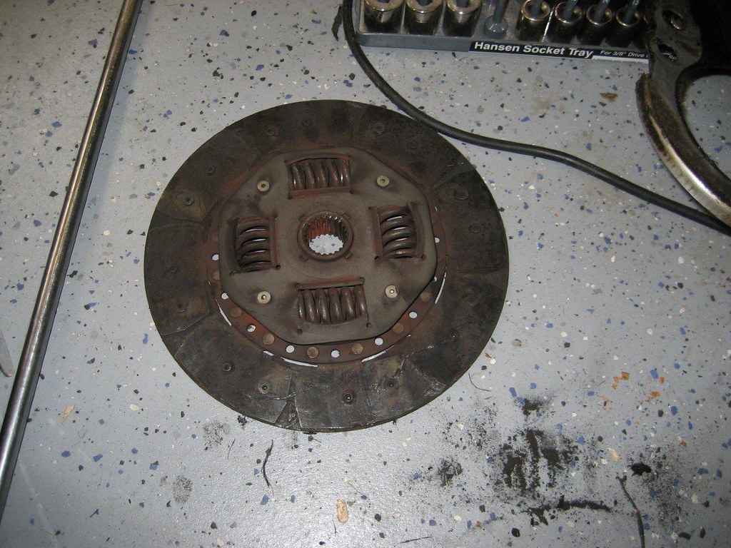

Since everyone likes pictures, here's the Luk clutch I put in.
Super Mild '90 Ranger

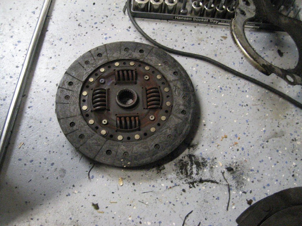

Here's the one it replaced:
And the other side:
It looks like it was a good time to change my clutch.
