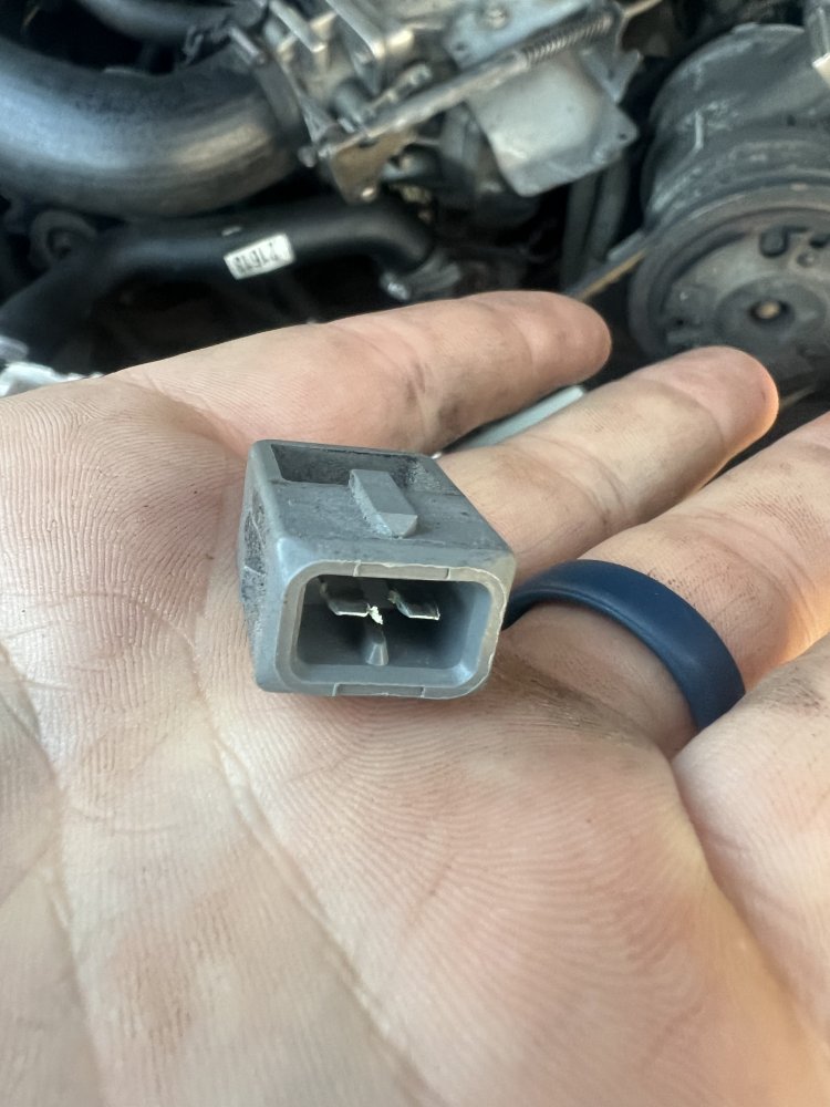

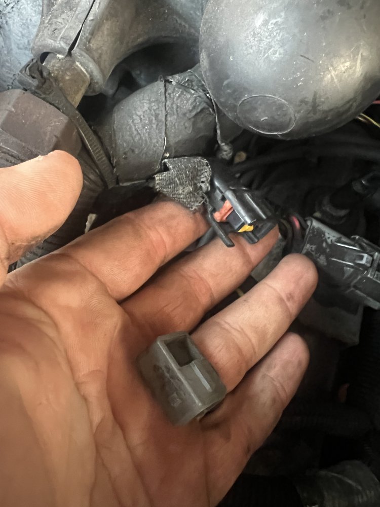

Alright I believe I found and unplugged the SPOUT connector, nothing seemed to change.

Yes that is indeed the SPOUT.
Have you checked the wires running to the coil plug? They like to break off inside the plug and sometimes push down into the plug and not make contact.

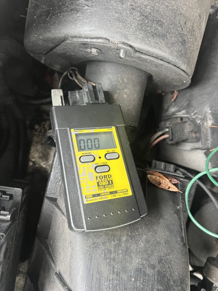

I finally got some time to work on this turd again. However, I can’t seem to get any codes or anything from this reader on either truck. Not sure if Im hooking it up correctly or what.
Turn key on, plug the tester in, and hold the "test" button for a second.
Or try wiggling the single wire that plugs in around.
You *may* have a failed ECM
Well neither the truck that won’t start nor my 94 4.0 is showing any codes.
Also if the ECM is failed the full pump and injectors wouldn’t work correct?
