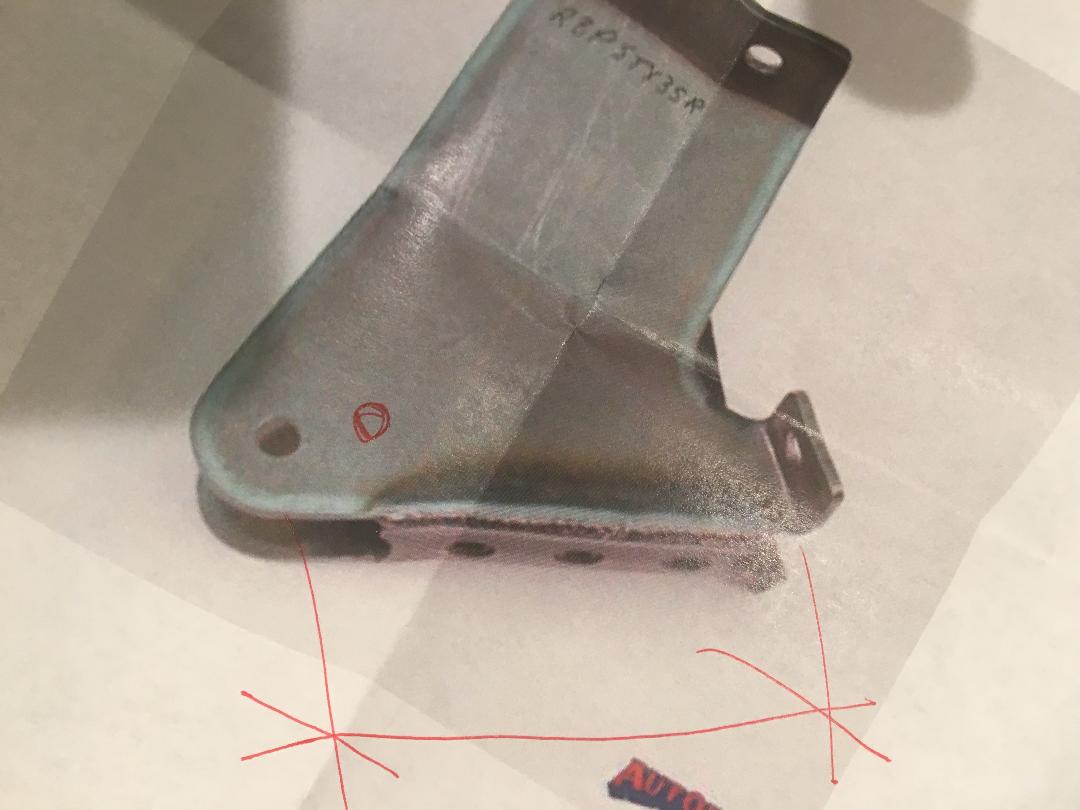

So on the passenger frame rail is the driver beam pivot, from the bottom of the frame rail to the pivot bolt center is what I am looking for, mine measures 6 1/2" and I thought I had STX brackets. I called Autofab and said his were 8 1/2" and his are the same as the original STX Pivots. I will try and post a photo showing what I am asking as far as the dimension.

Even if someone has the dimension of the stock bracket, I am just trying to figure out what I have.

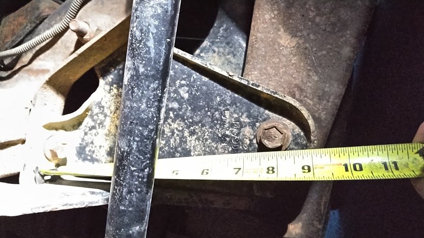

OK... you for sure have normal old stock brackets. For reference:
Stock height, 6-1/2" measurement (your photo shows the back side of the bracket.)

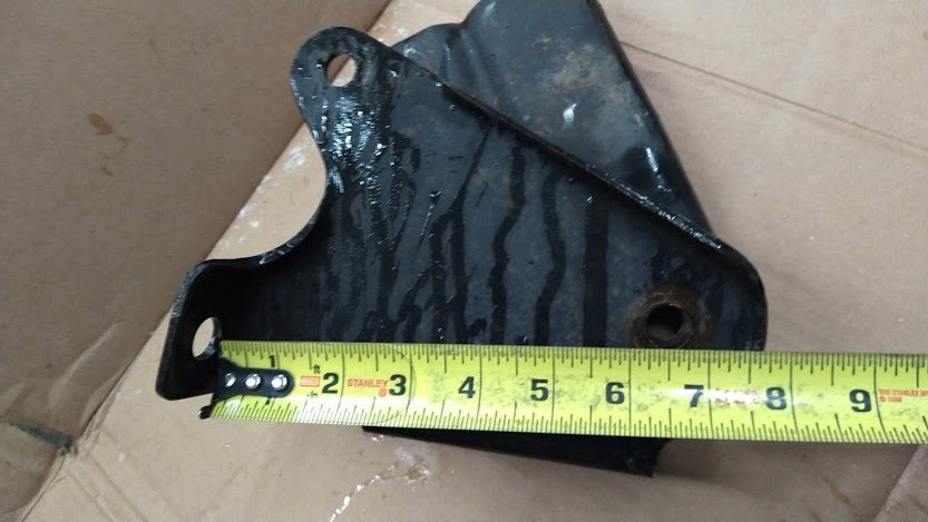

STX High Rider bracket, 8"ish

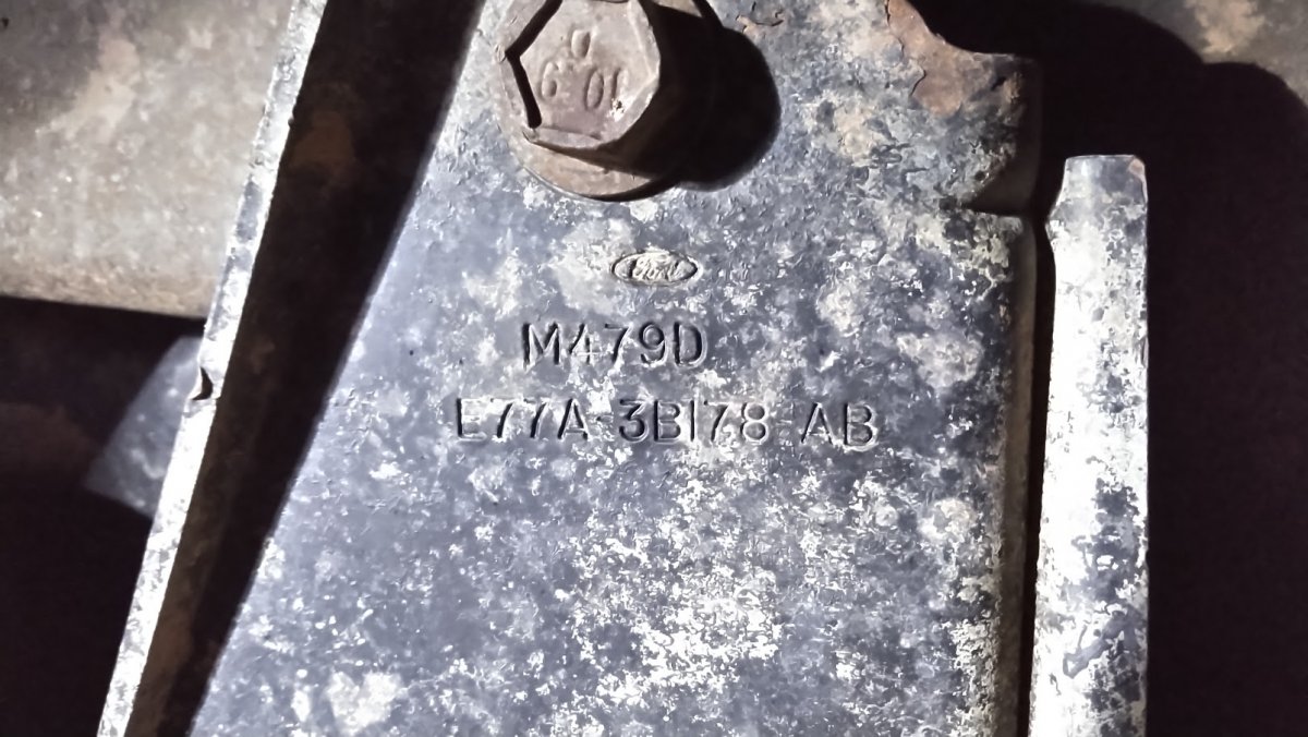

The Ford part number on my STX bracket (E77A 3B178 AB)

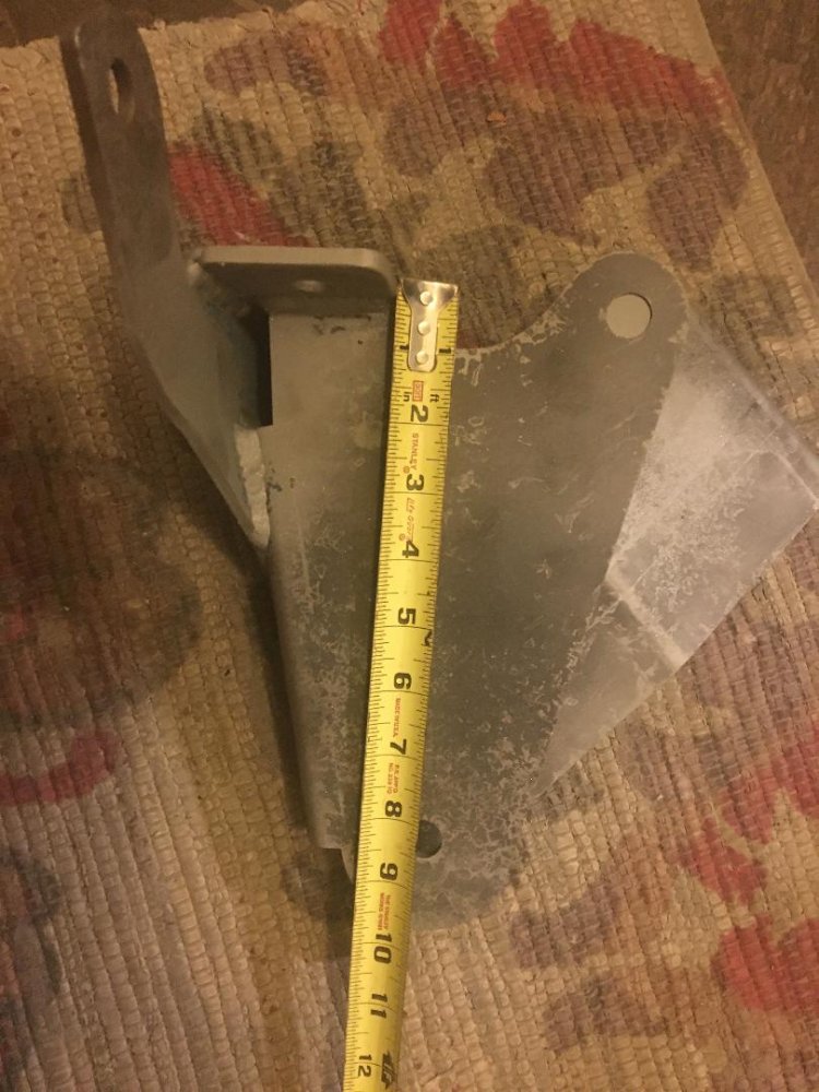

Thank you for the information. I have a set of James Duff drop pivot brackets for the 3" kit and the drive side is 8 1/4" and has the STX added gusset that mounts to the outside of the frame
. I am going to use them, If they fail then I will get the Autofab pivots.
