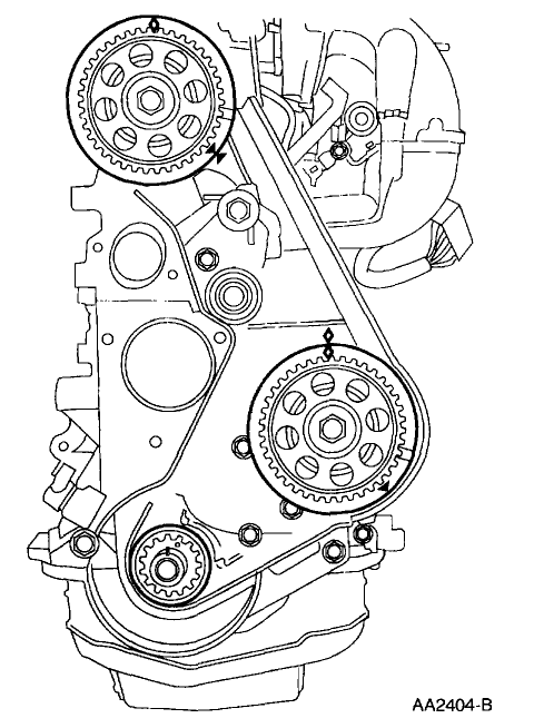

The timing marks should be on the cam gear and on the crank gear. Not the cover.
Basically the crank gear dot should be at 12oclock while the cam gear is at 6 o clock and the dots should be directly in line with each other.

I most likely misunderstood what you meant when you said you checked timing... I thought you meant spark timing... both the aux and cam gear need to be lined up but if both were lined up before compared to the crank and at least one of them is still lined up to the crank they should both still be right, if they skip it's always the crank that moves (way less teeth, easier to skip)
I found this in my saved pictures at work today that I saved for obvious reasons... (need to print out two and put in respective glove boxes...). So it looks like the diamond is vertical on both pulleys and the key is up on the crank or you can line up that dot on the crank pulley with a notch on the front seal housing...
I'll have to check the crank tomorrow. when i previously did the belt i wasnt able to remove the Harmonic balancer so I ... gracefully tucked the belt behind the crank timing sprocket. I used the line on the outside cover with a screw driver inside spark plug 1 to get presumingly close the process of doing sll that left ny cover pretty gorilla pimped though. s after the initial change but the belt has seemed loose recently so ill check again (I have a gesr puller now,) except this time name sure Cam and Aux still match Aux is is diamond ti diamond and cam is arrow to the genrrak direction of the arrow used to be kn the back cover.
