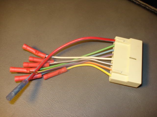

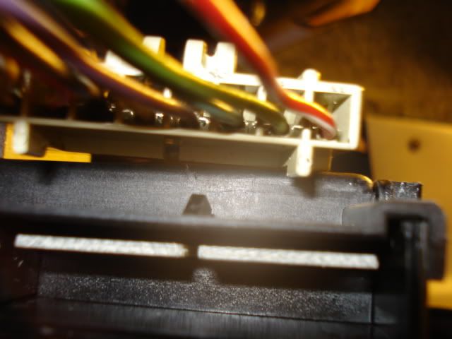

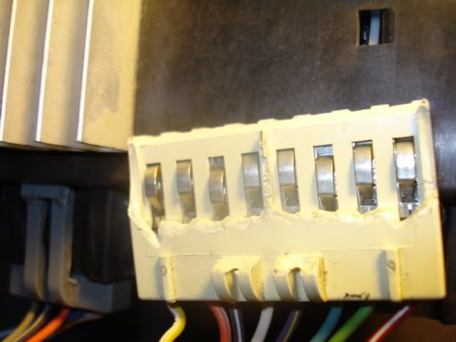

Pics of the new connector, as I found it, and the broken old one. I think this may be the problem. Next step will be to solder and shrinkwrap the new connector onto the old wires. This will be a PIA because of the location but it can be done.
The old connector:
The new uninstalled one I found in the same area as the module:
Old:
Thoughts?

Replaced the plug. What a PIA. Still does not work. I'll check out those links. Thanks.
