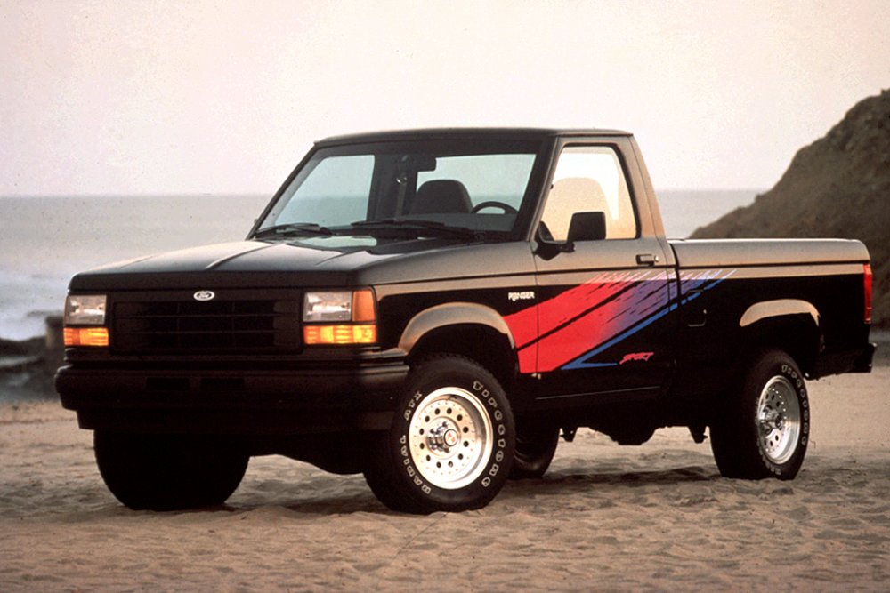

Hi all, I have recently acquired a 92 Ranger XLT which has 14 inch steelies on it but the tires seem a bit small compared to the promo photos I've found online for this truck. Does anyone have any tips on what these tires are, or if I will need a slight lift to get this look? I want to make the truck look a little more aggressive than it sits right now but without compromising the classic look and OEM feel.

Both of those trucks are 4x4s. By the 14 inch rims it is a safe bet yours is 2wd, so the two pictured trucks do sit about 2 inches higher front and rear than yours.
Those tires are probably 205/70/15 or 215/75/15. Both were common stock sizes for 4x4s.
