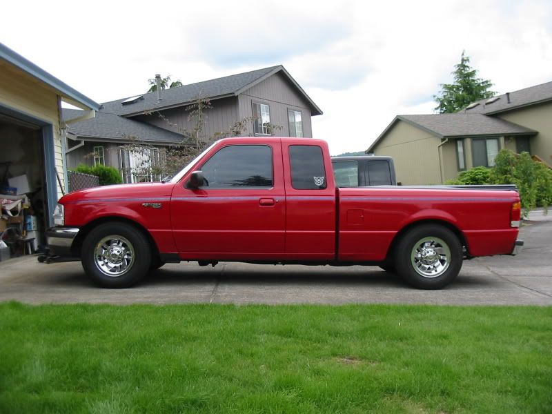

I have looked, but i am only finding pictures of rangers with aftermarket rims. I want to see if anyone has a stock picture of a 2/3 drop, and what all you have to replace? I found this kit : http://www.andysautosport.com/ford/...owering_kits/djm_suspension/djms00077900.html
But it does not include shocks. A buddy said when he did his s10, he didn't have to change shocks..so was wondering if i had to or not? Is this kit complete? Thanks for the help!
2/3 with stock wheels
Checkout http://www.illusivefabrications.com/ he should be able to put a kit together for you
That looks real good.

Do you have to changed shocks on the truck, or can you keep stock?
I changed the shocks to Belltech drop shocks, I think you can use stock shocks but I'm not 100% on that
You can use stock shocks with that amount of drop.
Thanks for posting up the link, if you have any questions you can email me brian@illusivefabrications.com. I would suggest running a set of the Doetsch Nitro Slammer shocks with any drop. The coil drop is what changes the shock length on the front and any drop on the rear changes the shock length. The lower control arms simply raise the balljoint and the upper control arms correct the upper balljoint angle and correct alignment specs.
