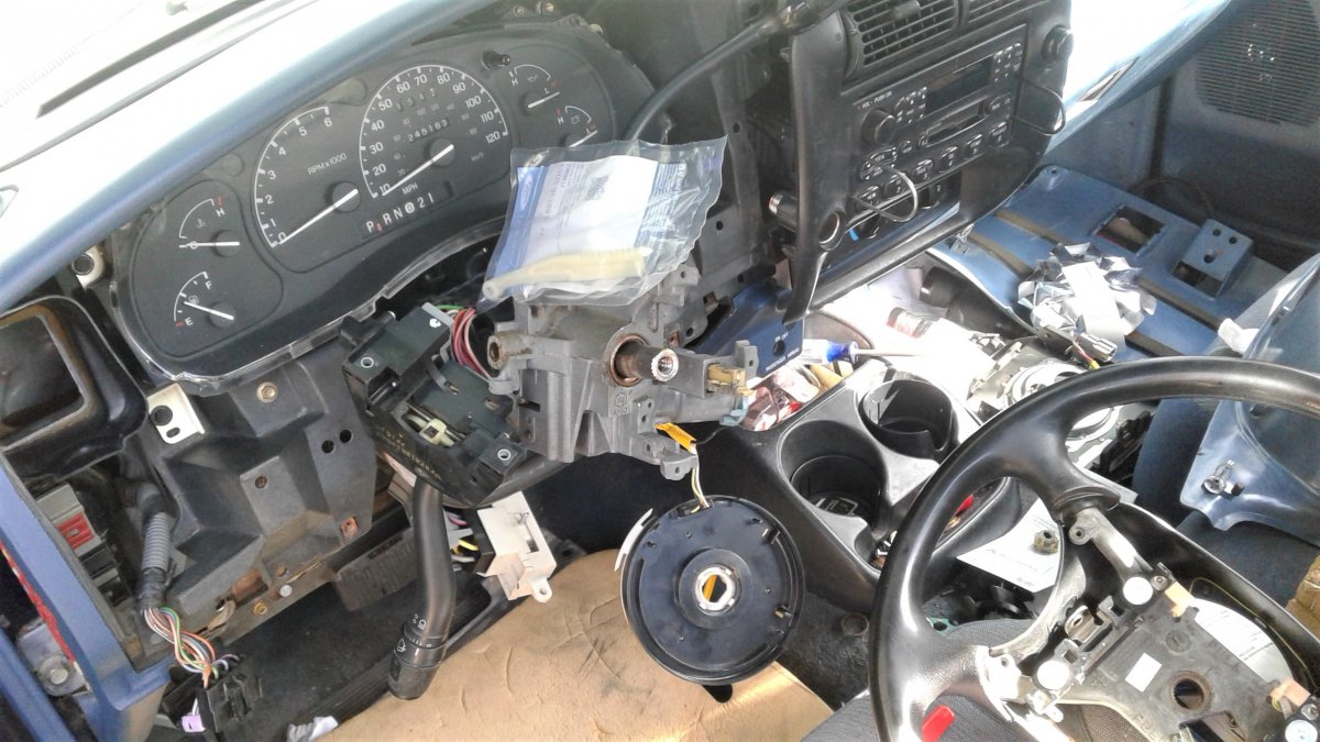

Here's what it looked like taken apart... Still won't start after replacing ignition switch & lock

Boy that looks like a 3 or 4 cups of coffee job

Here's what it looked like taken apart...View attachment 36422
Did you have to take those two star bolts out towards the back. One on each side, that go in horizontally?
