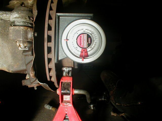

The secret to self alignment it getting the truck setting the way it rides. I pick it up, put jackstands as show in the picture so it's at the same ride height as it is on the tires. Tap the bottom of the jackstands out (a smooth garage floor helps) and you can tell by bouncing the truck when it's settled. Then set the camber. Put the tires back on, drive it around, put it back in the garage straight and set the toe by measuring the tread on the front and back of the tire until it is the same.
I may play with a laser level on the disk to do the toe at some point. Honestly, it's pretty damn far out before you really notice it. If you keep in mind that whatever you do to the coil is magnified out at the tire you may find you added too much leveling. What thickness of spacer did you add?
depending on the width of the tires and rims that placement woulden't give enough leverage on the ttb to reach ride height.they would have to be rather inset.the only reliable way to align these trucks is to leave the tires on that the truck will be driving around with and DO NOT pick up the front end at all before or during the alignment process.

I have stock rims and stock rims center the wheel over the bearing. I should have mentioned that.
I've been aligning my truck like this since it was a red '91 Ranger and I have absolute confidence in the method. I've had the same set of rubber on it since 2002, minus the two tires I tore on rocks. If you are running spectacular offset then it will not level it.
