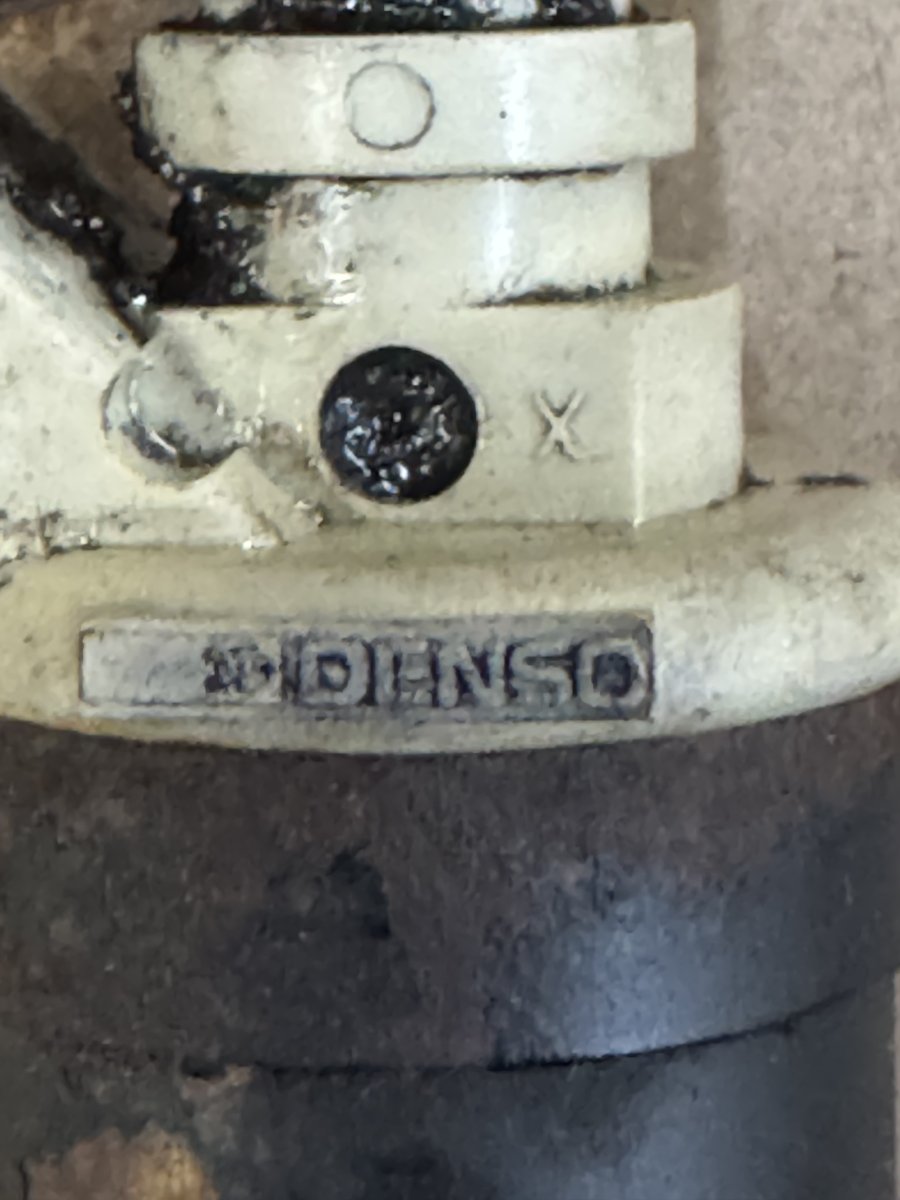

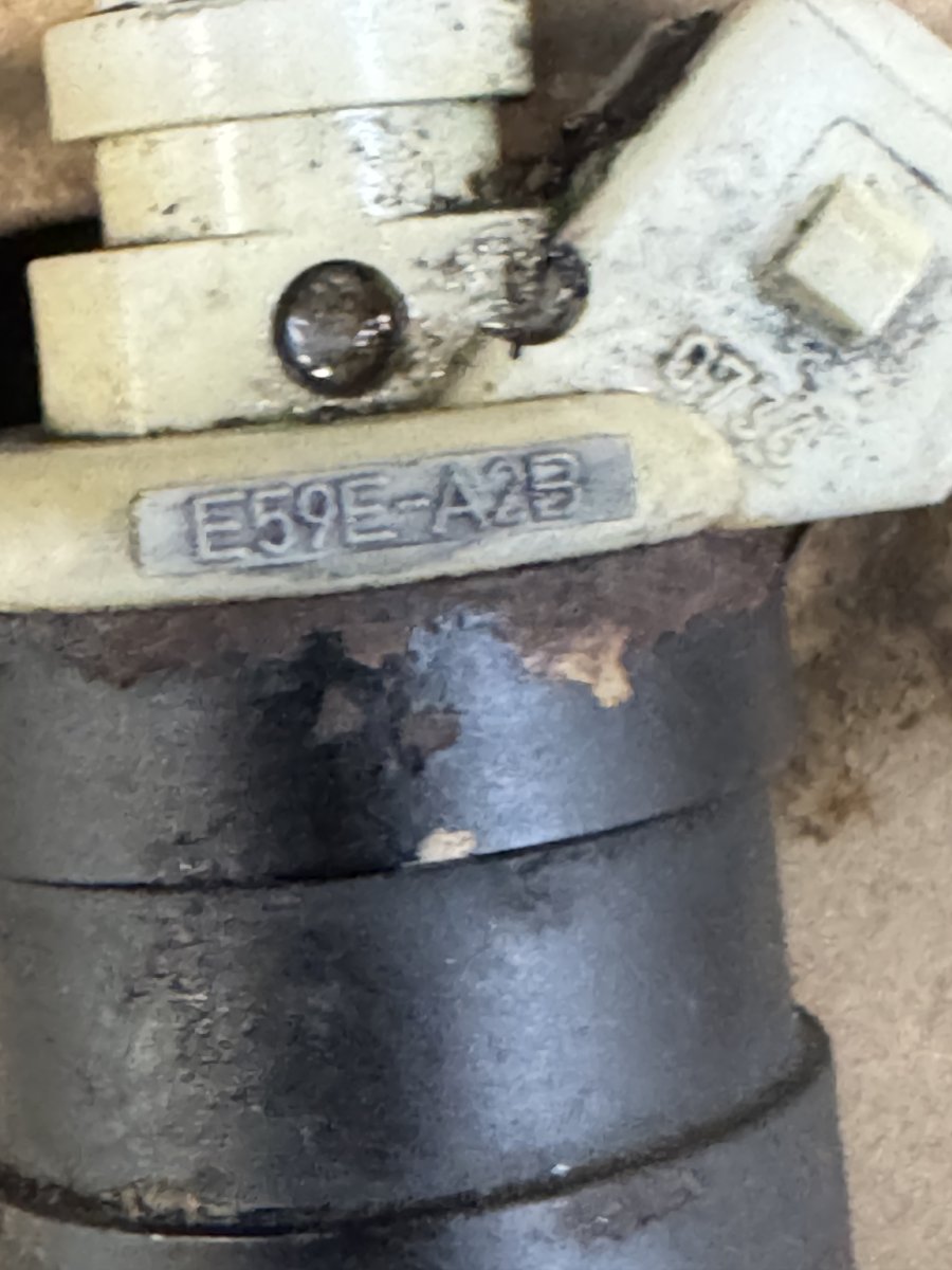

The Stock injectors on the truck from what I can tell were actually Denso and not Bosch. I looked through all my receipts and the fuel system had never been messed with. I also asked my father in law who bought it new and he confirmed he never had the fuel system messed with.

attaching photos of the (what I believe stock injectors) part number that I removed for reference
Also I do still have the originals and I have cleaned them. All of them except for one that is. One of them won’t pulse no matter what I do

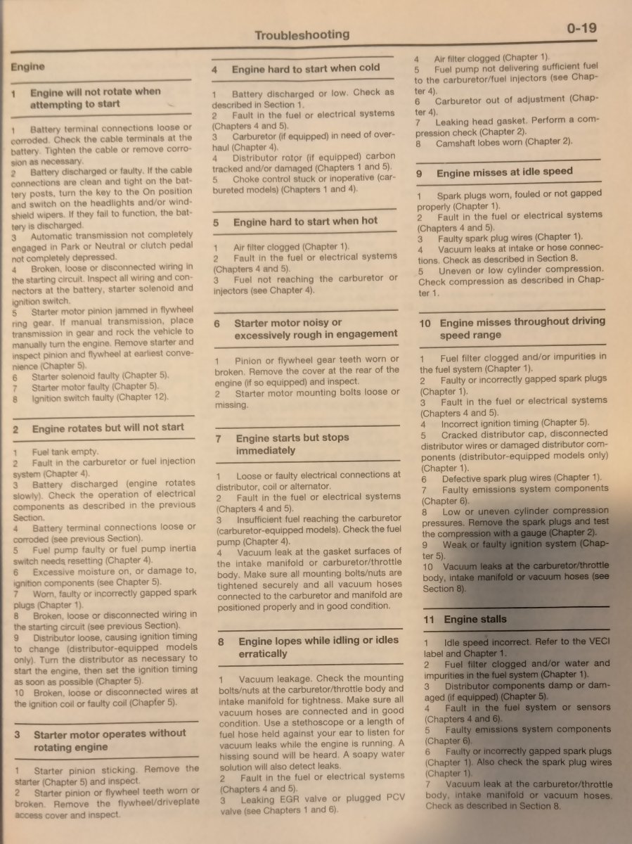

FWIW, not trying to read the manual to you, but this is the troubleshooting page of Haynes... going through em (#2 crank but no start)..
You put more than just 1 gallon in (the pickup sits 1/2" to 1" off the bottom and takes 2-3 gallons) - but again that shouldn't be considering you got pressure....
etc etc... can look at the #4 list as well since it is kinda applicable.
I snapped that pic a while ago, then returned my loaned copy from the library - so I don't have other pages right now.
I would probably check pressure at all conditions to make sure you are getting good pressure all the time.... but again cause new parts are so crappy now a days - new pump.
