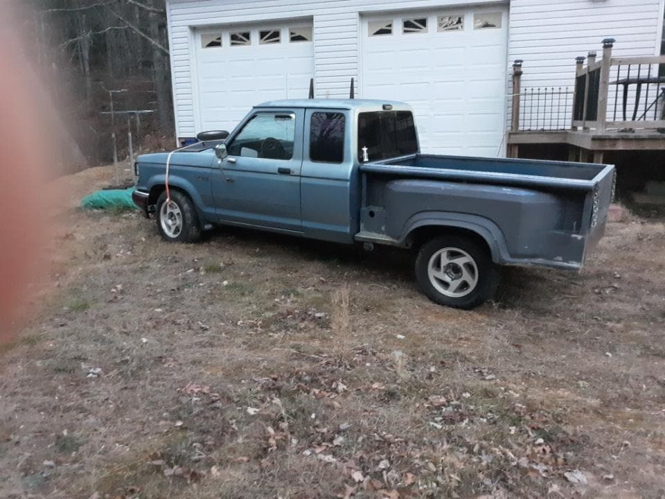

I held off posting this for a variety of reasons - first and foremost, I was trying to buy it (and I did buy it yesterday) and did not want to generate a bunch of interest and simply out of respect for the owner.
So here it is. What I can tell you is that it is NOT a genuine Ford product - the bed is 100% aftermarket conversion parts but is very well done. It was apparently made by a company called Recreational Designs, Inc out of White Pigeon, MI. It is all fiberglass, including the tailgate. I think RDI probably added the visor, graphics and handles as well.
I first saw this truck about 10 years ago and thought it was super cool. I spotted it again about three months ago sitting by a garage with four flat tires and weeds growing up around it. I left a note on the door of the house stating that I was interested in buying it and the owner called me in July to say that it is in fact for sale. Several weeks and some negotiation later, it came home with me. This was apparently the PO's father's truck. It was purchased new locally at McKie Ford and was daily driven up till 2011 when a new vehicle was purchased and this was parked and left to sit there.
Unfortunately it is not in very good shape - the doors and front fenders are quite rusty, it needs tires, a windshield, battery, exhaust work, rear axle seals and probably new gas tank & pumps.... but it actually fired up and I drove it off my trailer and into my shop!
Specs are pretty basic - 2.9 V6 engine, 5 speed trans, push button 4x4. It is an XLT but is missing cruise, AC, PW/PL/tilt and that's just fine with me.
Enjoy - it may not be the incredibly rare Shadow prototype but I'm guessing it's the next best thing and we may never see another.

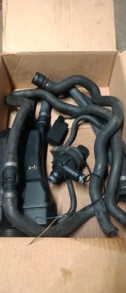

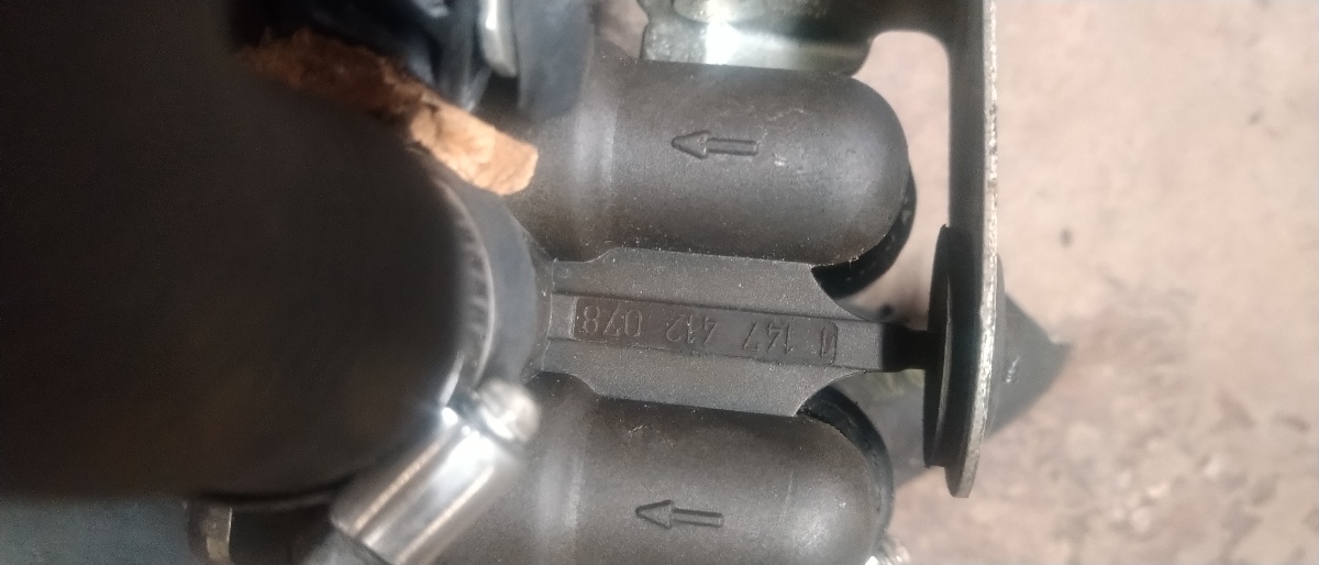

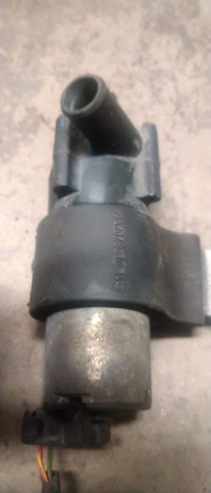

Benz/BMW cabin heater water pump spliced into a heater hose solves all 2.9 overheating issues. Gives you a second cooling system using your cab heater as a radiator. Just wire it so that when you kick the blower on, it comes on.
Also really nice for cold days as you don't have to have the engine running to stay warm. Just let it heat back up every now and then. Yes, that's why Benz and BMW have the in their cars. ?

Nope. Just always cruise the German section of the JY to enjoy some refined heaps of crap. Disassembled an alfa graduate over the summer in the yard for the hell of it. Do that to the cool stuff every time I've seen it. It's how I've learned to do the crap I do to perfectly innocent Rangers.
I poked around a mid 2000s BMW.5 series, started Googleing part numbers of crap that looked strange, and found that all the coolant hoses were for this huge heater system plumbed all through the cabin and body to combat the goddamned massive V8. Great engineering.
Benz one is designed for passenger comfort. With luxury comes cool stuff like independent zone control solenoids. The mb one was out of a C230 kompressor (considering trading the Honda for one to commemorate how frigging many of those I've stripped clean). Comes with a really cool coollant splitter with individual electric solenoids for each "out". Still spitballing cool crap I can try with that one.

As promised, from the bunker:
Mercedes pump and valve:

BMW pump, valve, hoses, overflow bottle, and some related sensor that I can't remember what it does, but I do remember it was worth grabbing because it's somehow related:
