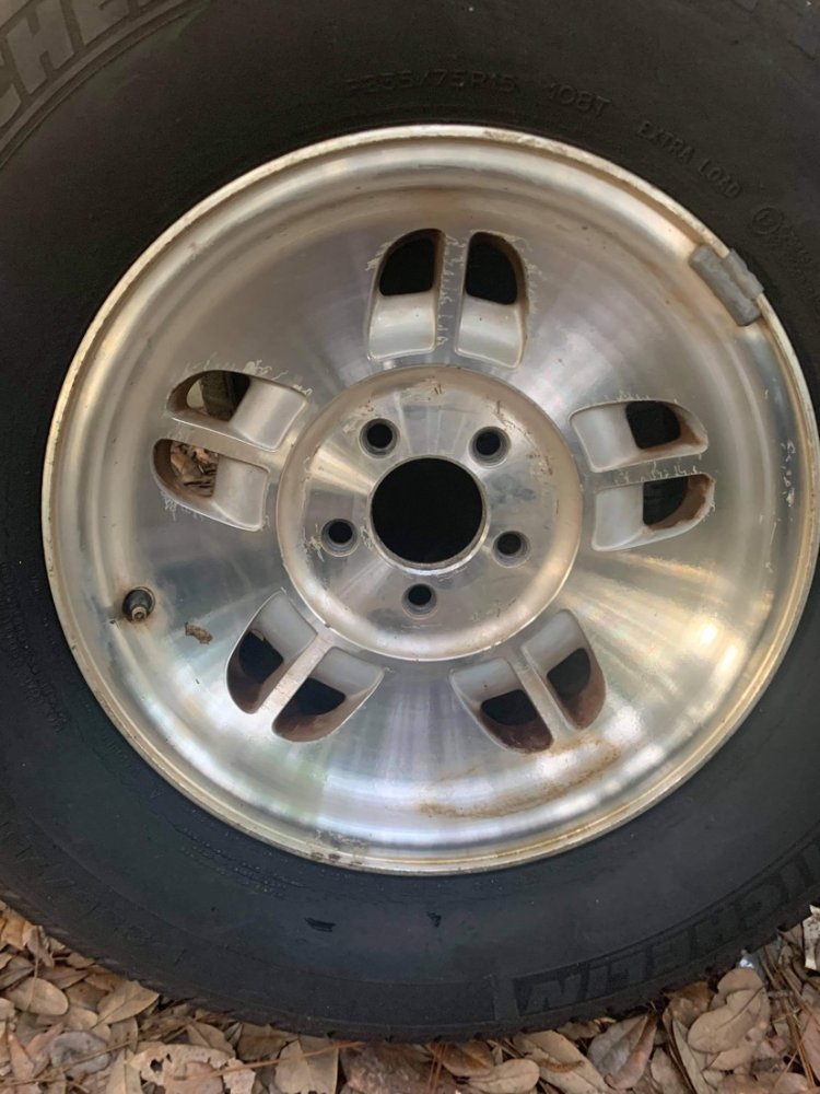

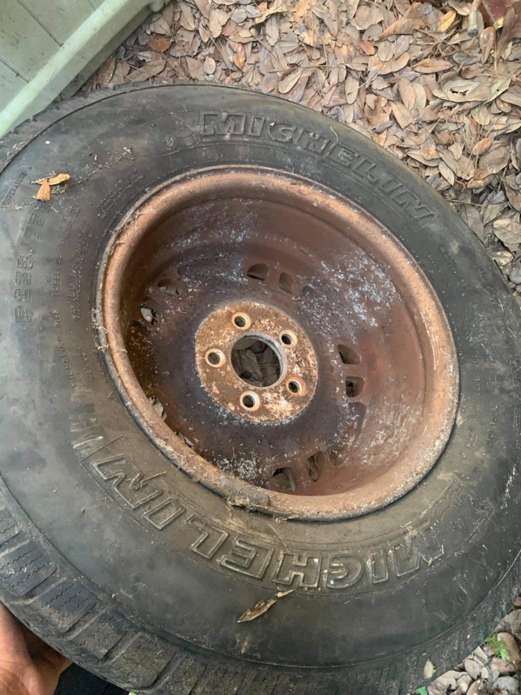

About a month ago I purchased 15x7in steel wheels for my truck and put good AT tires on them. Love the look… However, since switching to a 15in steel wheel from 14in aluminum, I know I added weight, but I’ve had issues with handling, horrible vibration, and they are out of round. I also had a noticeable change in throttle response… it ain’t getting out of the way now. I recently came across 15in doe track style aluminum wheels that a guy is selling for $125 for all four. Would I be saving much weight keeping a 15in wheel but switching to aluminum? Is the switch worth the price?
I attached a picture of the wheels I’m looking at.
My truck is a 2.3l 2wd so I know I don’t have much gut to begin with.
Thank you in advance for the help!

Stock tire was 14in wheel, I believe I ran a 225/70R14. Currently running the 15s with a 235/75R15. I’ve also had them balanced three times and one shop saw that the 15in wheels where out of round and said that they’re steel and would be like that.
Just wondering if a switch to a aluminum 15in would help with ride and weight.
You actually helped a lot with the issue with hub centric rings. I appreciate it!
You've gone up over 3" in tire size so that's why there's no power. Has nothing to do with weight. Aluminum rims that size are not that much lighter that it would make a noticeable difference. If the steel rims are bent they are bent so nothing you can do but replace them, but the aluminum rims won't make any difference except hopefully not being bent and being able to be balanced properly. It'll still drive like a slug...
Reading it again, it makes absolute sense. Thought maybe the switch to aluminum would save more weight and regain some power. But hey, it’s a little four-cylinder, not much you can do with them. Lol
Looking on rock auto, the shipping weight of a 15" aluminum wheel is about 1lb higher then that of a 15" steel wheel. These are OEM refurbished though. You may be able to loose some weight going to an aftermarket wheel, but it would probably be marginal.
