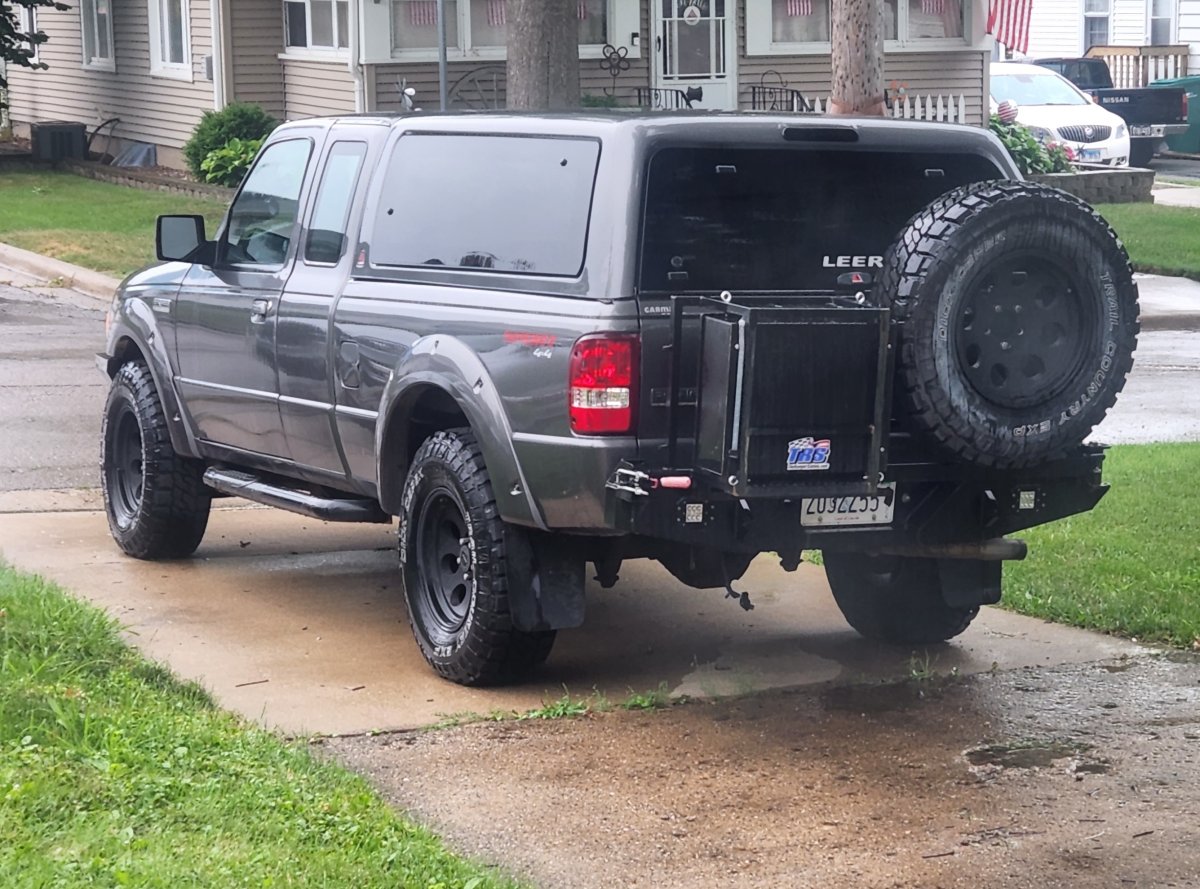

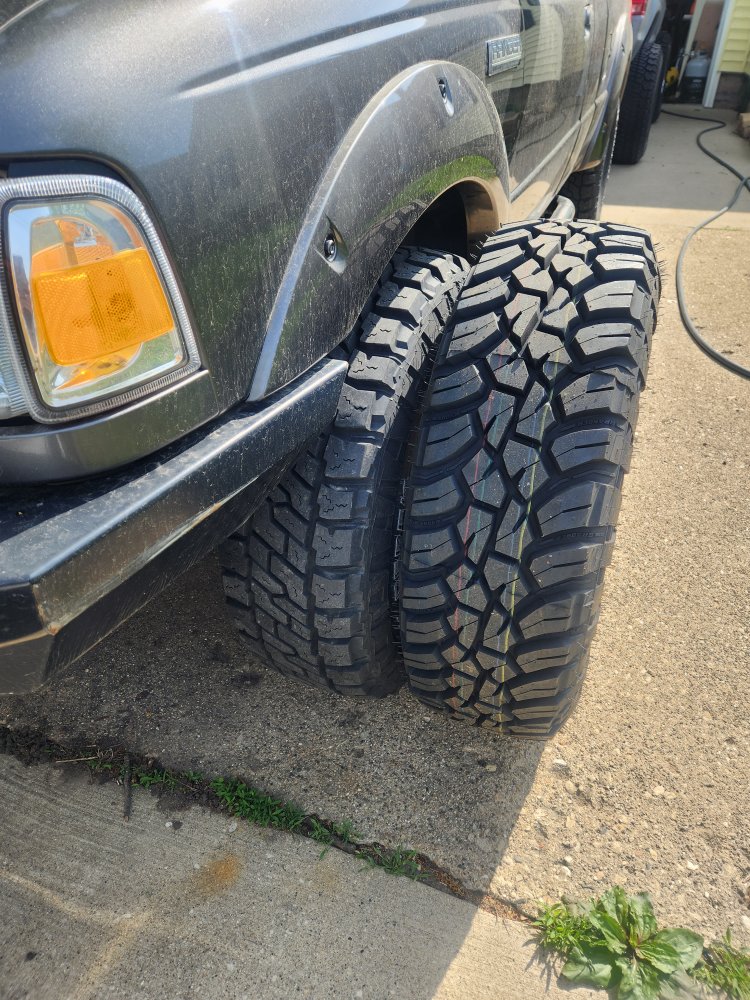

This my truck with the 265's at factory height and the second is same tire with a 1 1/2 torsion key lift... 1 inch shackle lift in the rear and new 1750 lb rear leaf springs.
This is what a 33x10.50x15 looks at factory ride height...

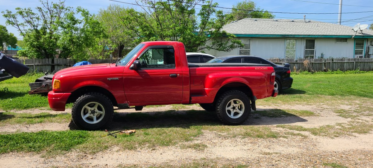

Dang. I was going ro post pics od my truck with no lift and 30s but i cannot find them using this new set up android downloaded a bit ago
Ok, this is weird but i found a pic.
So, 2004 edge with torsion bars set to stock height and no rear lift with 30s. I dont know the wheel offset but they came off a 98 wrangler when he got new wheels and went to 32s
