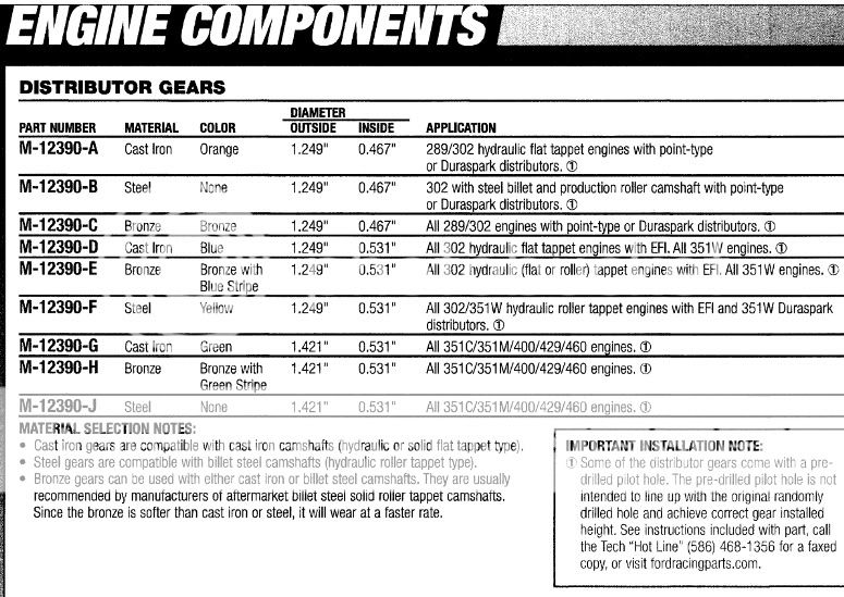

So I am looking for a steel cam gear for the Duraspark distributor I am installing in a 87 5.0 roller engine........ I have ordered ones for an 85 Mustang Gt 5.0 carbed manual tranny and both I received are too big for the dizzy shaft... so I have searched some more but not found a part number..... now to the question does anyone know the Part Number, we have Napa and LordCo here for parts so a Napa part number would be a bonus. Thanks.
Well don't have the NAPA number but looks like the Ford number is M-12390-B. Maybe they can cross reference to that.

You're ordering for the motor application instead of the distributor application. The Duraspark uses a .467 ID cam gear(same as a points distributor). The 87 distributor uses a .531 for it's TFI distributor.
The dizzy I am using is for a 77 or 78 302 and is a duraspark version. The parts stores here need a make/model/year/engine to get part numbers.... so I ordered a gear for a Ford/Mustang/GT/302/Carbed/Manual transmission.... but I received the larger ID cam gear..... which I guess is for a TFI dizzy.....next is trying to order a complete dizzy for the 85 GT.... which is too bad as the duraspark dizzy I have is a new/rebuilt :(

Order it for an 85 Mustang GT with manual transmission. That was the only application for that gear/distributor.

It was for dimensions and part number. Do you know where to find part number for the gear was his question, it needs to have a B on the end of the number to fit the points or duraspark dizzy. $79 and $80 dollars seems to be the running price for that gear ebay has free shipping if he wants to wait.
