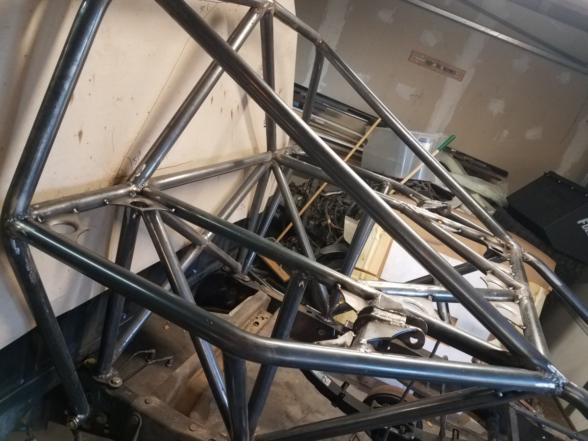

New to the site and to building anything other than crawlers. Just started a 4x4 prerunner build on my 06 XLT.
My plan is-
Rear: Deaver G50 w/ 16" triple bypass Kings
Custom bedcage (full bed removal)
Front: BTF 4x4 Longtravel Race front w/ 12" bypass and coilover Kings.
Here's my work so far.

Welcome to the site. Nice cage work.
Sweet caging. Are you building it yourself? If not, what shop(s) are you going with? What else do you have planned suspension wise? If you ask me, the autofab 16" wheel travel kit is probably the sickest...
Yeah man I'm the only person to touch this truck. Gonna be keeping it that way until I get to wiring. It's an '06 4x4 so autofab kits don't apply. Suspension is listed above. The BTF kit cycles 18" probably gonna strap it around 16

the cage work is looking good. are you going to add any structure where the bump stops are
Yeah. I'll be boxing some sections of frame rail and adding some form of crossmember. I've left it out for now so that i could have space to get in and weld on the underside of the cage more comfortably
