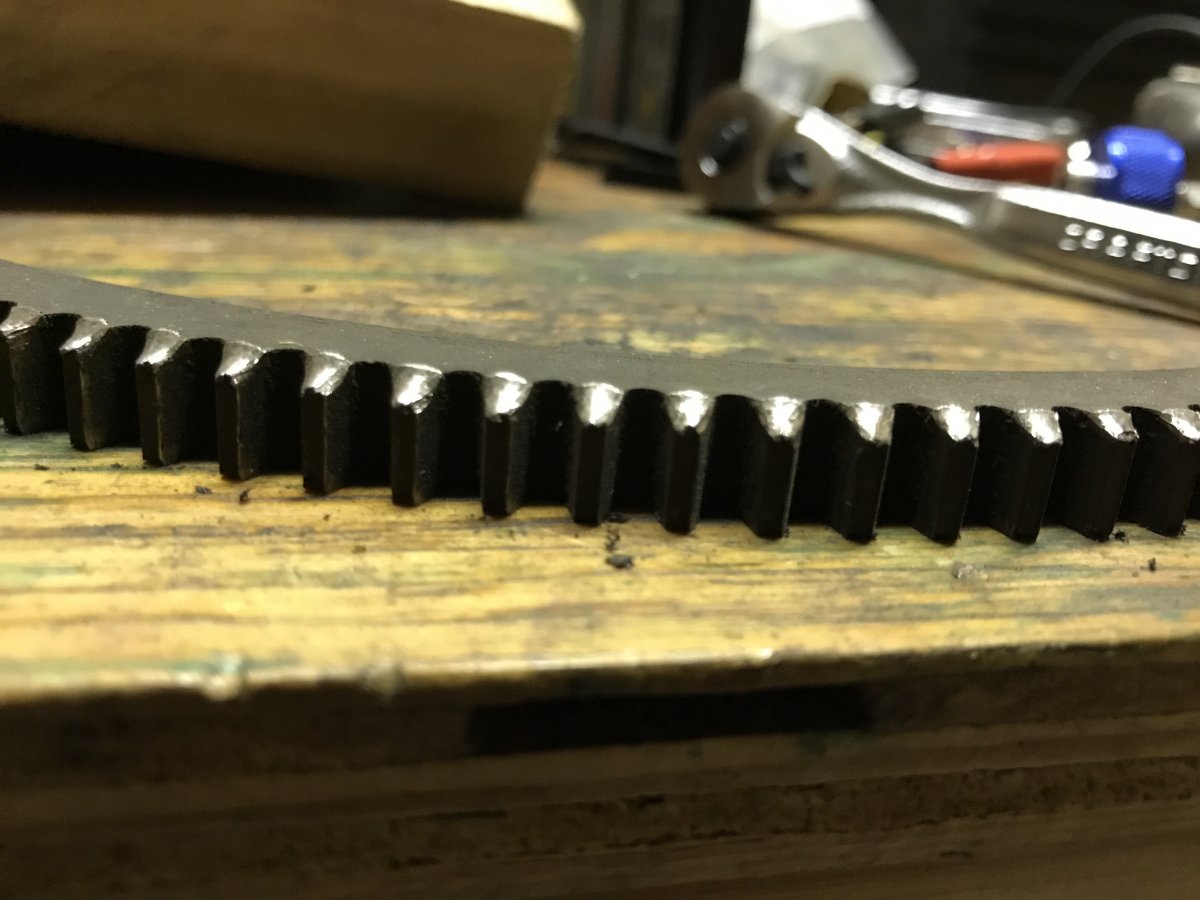

The flywheel teeth I saw in your picture looked great.

The attached picture is the ring gear I replaced on my flywheel; it didn’t cause any issues.
