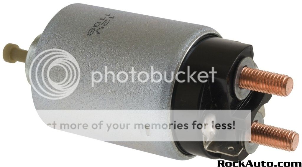

You might remember I broke a stud on my starter motor (Here's the thread) and soldered it back on. That worked for about six start ups and then something pulled on that wire and snapped the stud off again. I ordered a new solenoid from RockAuto and when it came, it did not have a stud connector but a spade connector as shown here.

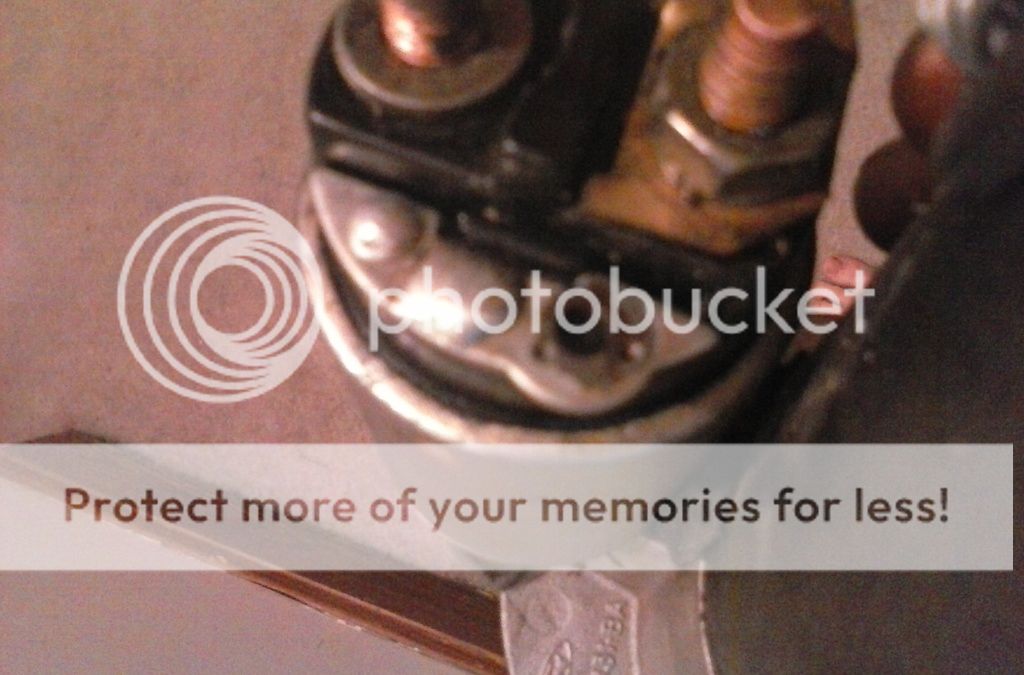

The broken one for reference, you can see the place where the stud attached.
I found this thread explaining that Ford had an issue with the spade connector and provided a conversion kit to get to a stud. I have an eyelet connector on my wire, should I change it out or should I send my solenoid back to get a solenoid with a stud?
After reading the link, I would exchange it for the correct one.
Sent from my XT1032 using Tapatalk
That soldered spade terminal looks more skookum than that welded stud.
I would just drill the hole in spade larger and use small bolt to make it a stud :)
I like the spade better though, so I would change the wire end, never had a problem with any spade connection, outside of them being pulled off.
BUT(big but).............pulling off is a GOOD thing, the small studs don't just break one day, they get pulled and break, and you are S.O.L. until you can get it fixed.
With a spade you just plug it back in :)
Maybe just solder a spade on your old one and change the wire end?

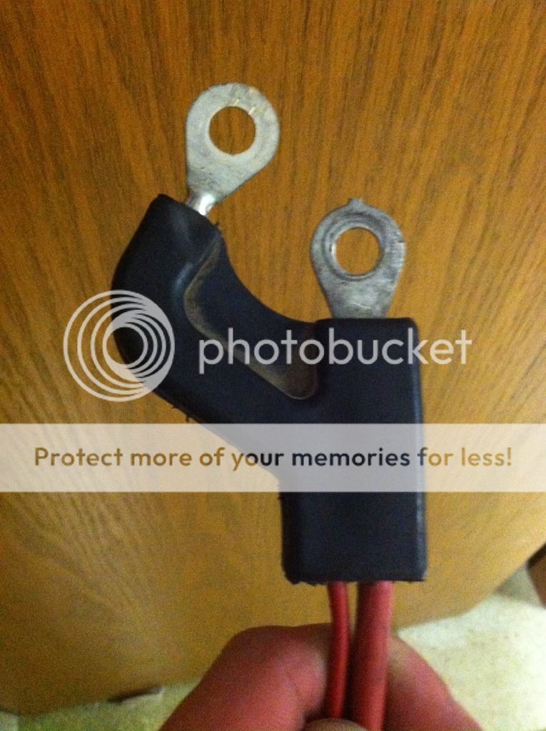

One last question, is there anything important inside the black rubber on this thing? It runs from the positive terminal to a round white thing on the drivers side fender wall right next to the fuse box, (I would go out and look but my car is parked a half-mile away). My guess is it's idiot insurance so the terminals can't be installed backwards.
Just an insulator and a way to keep the cables in the right position. This was part of the problem that I was having with intermittent starts leading me to think the starter was pooched and that I had picked up gremlins.
