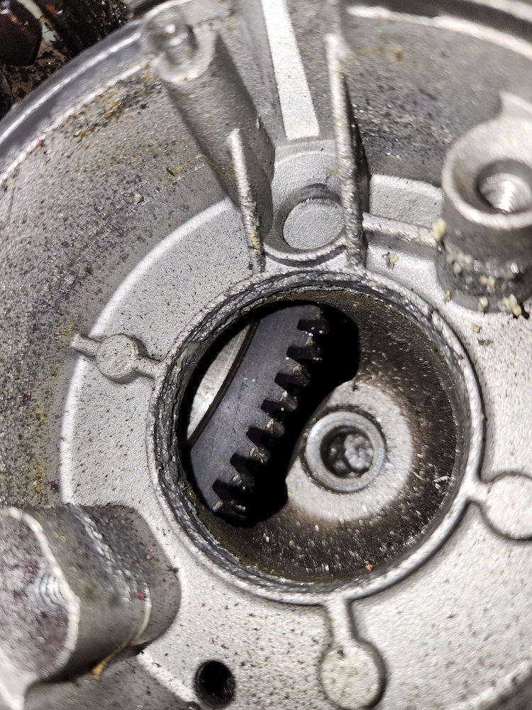

Block plate is there, engine turns over, I'll try the shims. Took one of the starters apart to use the nose cone to get an idea of how far off it was.
