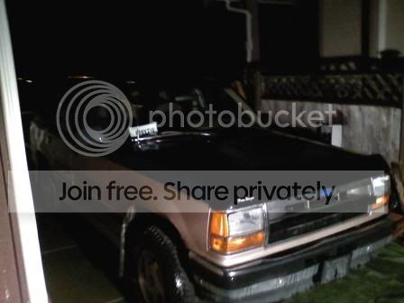

well last week i picked up a 94 explorer with a good motor and trans body is shot and it wouldnt pass inspection... so im strippin it down and swaping them motor, trans, dash, diffs... the whole works... so here we go..
this is the work place on the side of my house..
the exploder...
gutted inside...
window gone.. they were in there good..
pile of stuff..
the old 2.9L
cuttin away..
now the sides..
off came the top..
thats where it's at as of last night..

ok so today i gutted the explorer and took care of some rust in the bronco... i have some welding to do still (cracks in the floor board.. nothing to bad)
the explorer
the bronco
the 2.9L ready to be pulled!!
thats it up to day untill i get of work tmr.. gonna go shopin for some new tools :)
