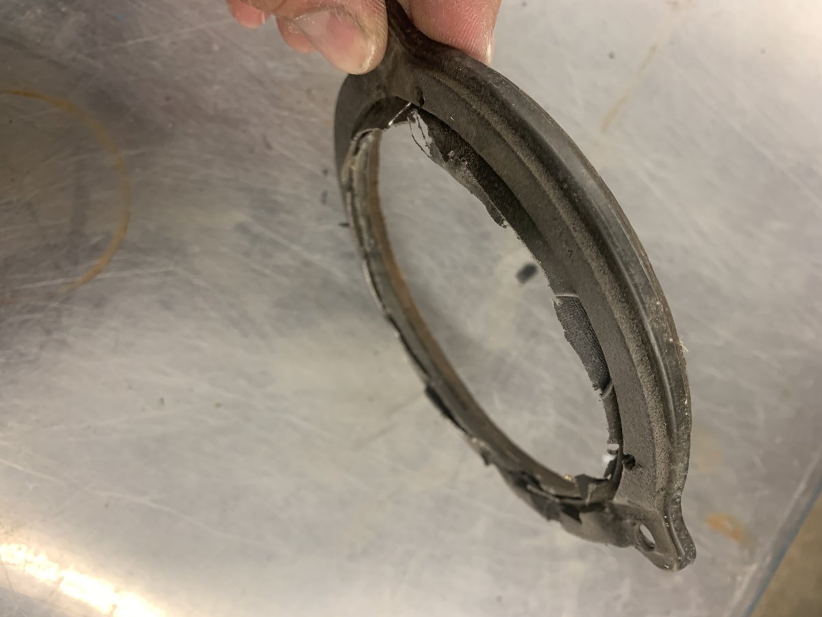

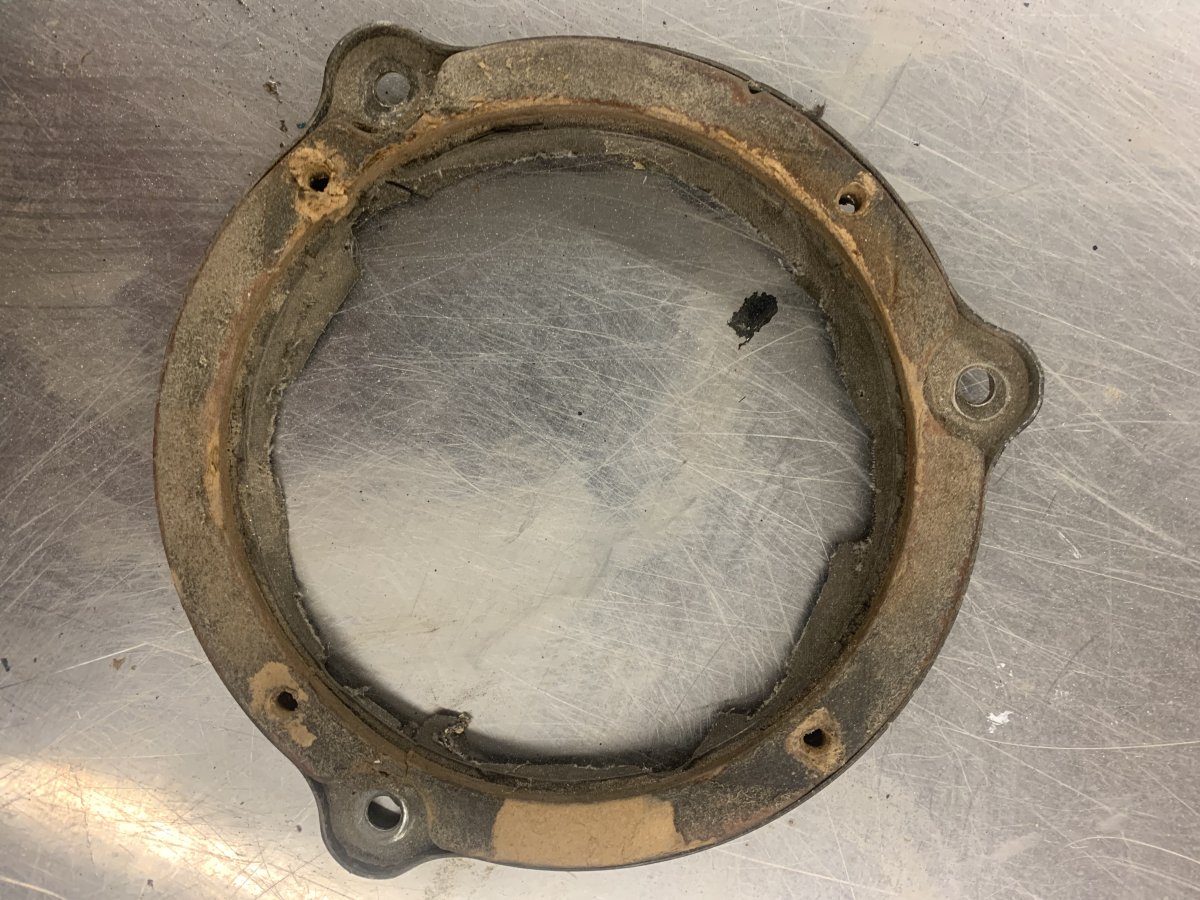

You can also use the original speaker instead of the Etsy mounts. Just cut out the guts and leave the ring of the original speaker and self tap screws into it. That’s what some crafty fella did on mine when I pulled the dash to restore it. 👍🏻
