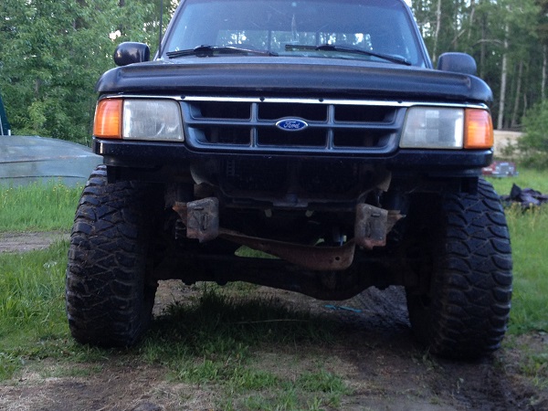

I am running a 94 and went to F-150 springs and 1 1/2 of washers to give me the lift I was looking for. This is before the front end alignment . :yahoo:

Those f150 coils can't be very soft though...
