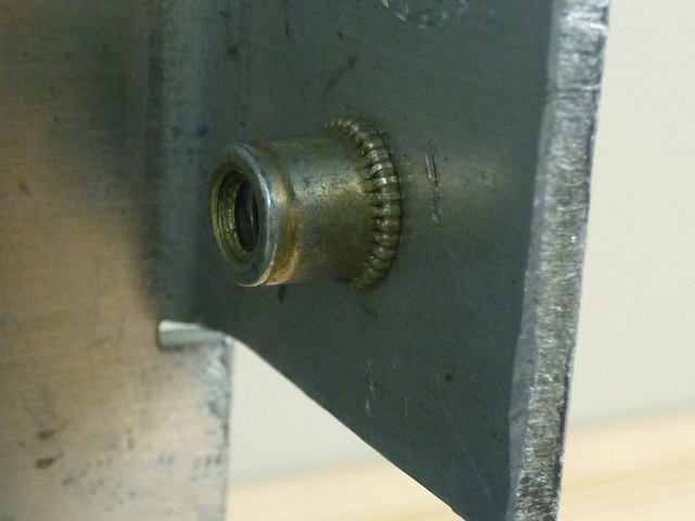

There is a tool with a threaded stud that crimps them down tight before you run a regular fastener through them. The middle part is not threaded, just the end. So, the middle gets crushed down to swell in the hole and crimp on the blind side sort of like a pop rivet. The thread part serves as the nut after the rivnut is installed.
Like this:
