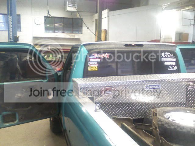

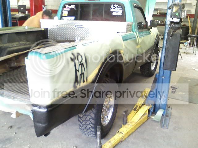

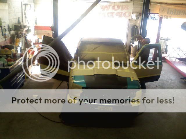

I made my truck match my hood today.
Used the same professional spray-in liner as the hood.
After the pics I removed the ugly stripes, and put the tailgate back on. Now I need to finish building bumpers.

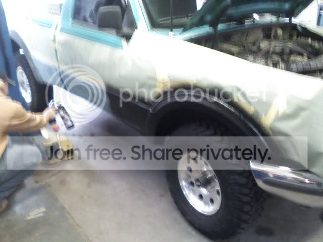

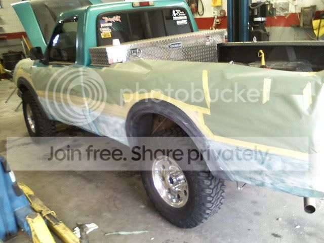

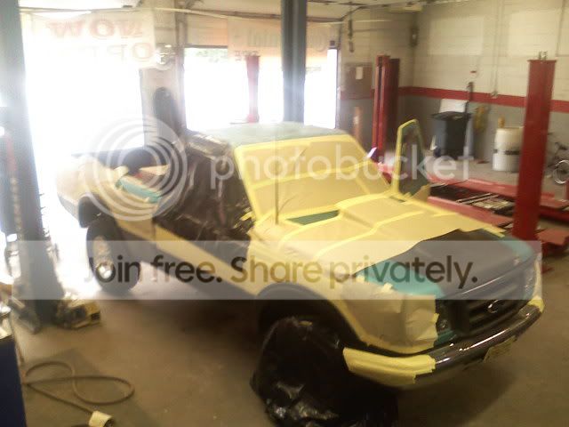

It's made by a company called U-Pol, it's called Raptor Liner. It comes in a kit 4qts of liner, 1qt of hardener, and a special paint gun. Just sand the paint down with some 80grit, and spray. Dries to the touch in about 4 hours, fully cures within about a week, depending on how thick you spray it. Comes it black or clear witch you add whatever color paint you want to. I don't know where to get it my paint guy gets it from his supplier. The kits cost around $125, 1 kit did my whole truck.

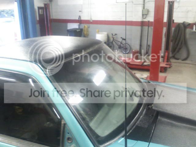

Sprayed my roof, wiper cowl, and the mirrors. Also added another coat to the sides.
