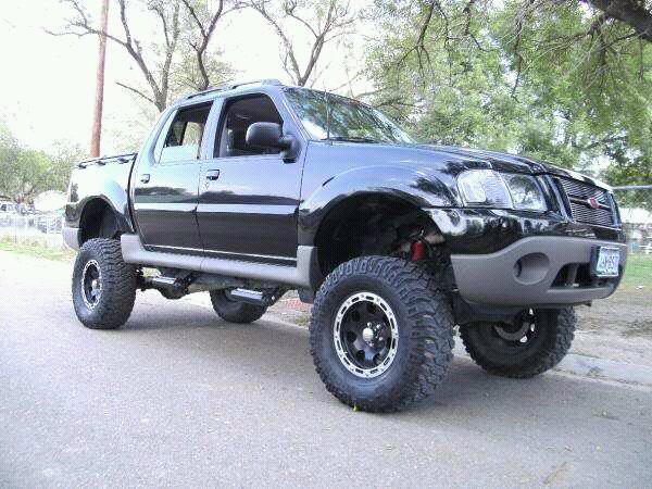

Found this on Google Images, it has the perfect stance. Whatcha think is under it?
Sent from my PG86100 using Tapatalk 2

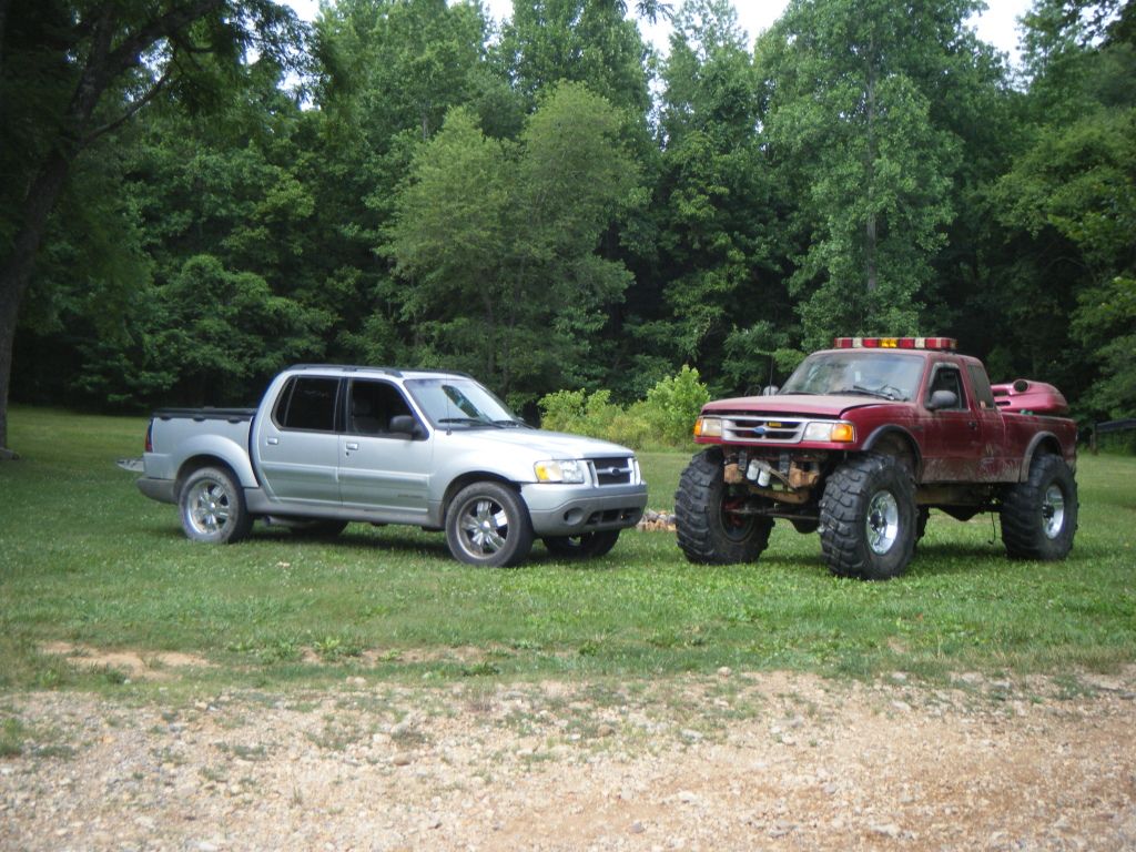

Here is stock height on 32's next to SVT on 47's...
SVT
SVT
Looks nice, but don't have the height I'm known for.
