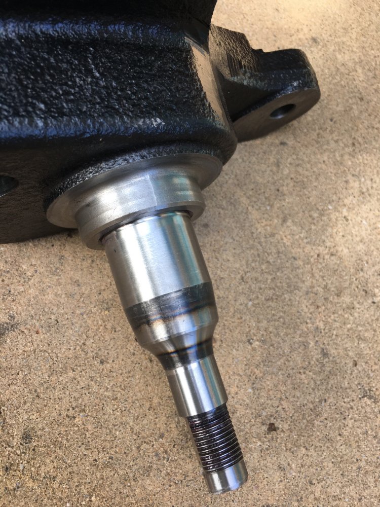

I purchased a 4” spindle lift for my 02 coil ranger
lift part number 703030B https://maxtracstore.com/2001-2009-f...xtrac-703030b/
After installing on test drive I get a loud road noise (roaring) like a bad wheel bearing, I replaced all wheel bearings and still have the sound
I put the old spindles back on and noise goes away …
I noticed on the new spindles after driving on them for only a couple minutes some heat rings as seen in photos
Any idea what could cause the road noise?
Also any tips for removing bolts from leaf spring shackle??? Spent several hours with no luck Spindle lift road noise
for the big ring that looks like the inside of the hub was rubbing on the shaft. the smaller ring would require exploratory surgery.
I would be worried the smaller ring may have weakened the metal.
