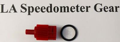

This is the one I bought from eBay. It works and installs in less than 5 minutes.
My truck has 32” tires and 4.56 gears. This is a 21 tooth Speedo gear. It is within a few mph of being correct.
