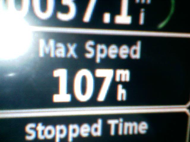

‘90 supercab 4.0l. On my way to Carlisle, I was bouncing off the speed limiter for about 2 hours. (IIRC the speed limiter was 90-92 mph. @Dirtman )All of the sudden I just stopped hitting the speed limiter and was free to go as fast as I wanted... The speed limiter never worked again!
38047
