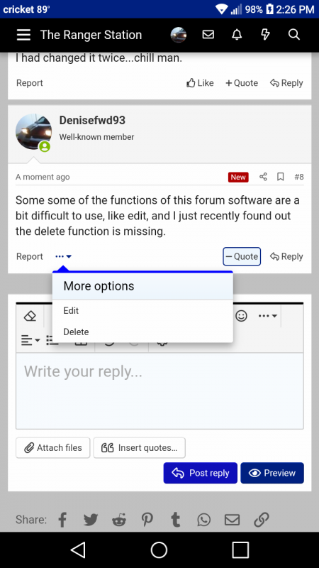

Some some of the functions of this forum software are a bit difficult to use, like edit, and I just recently found out the delete function is missing.
But it's magically back on this thread but not on my threads I get real confused maybe, I'm just getting too old for all this stuff, screenshots don't lie
