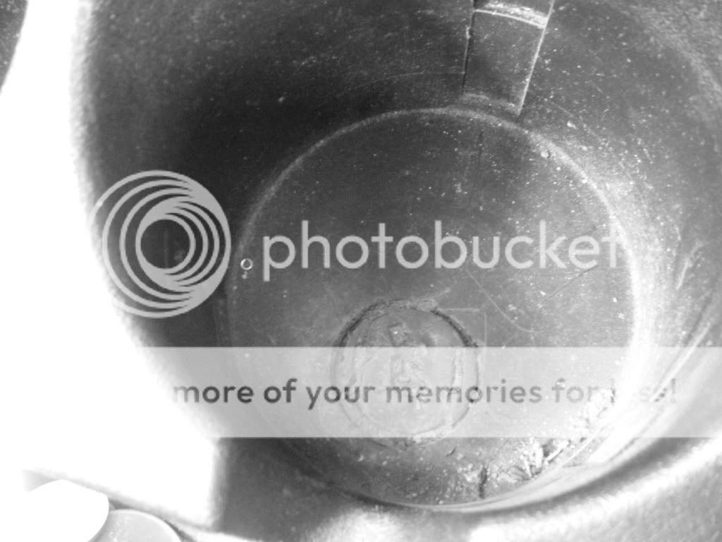

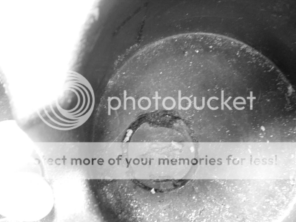

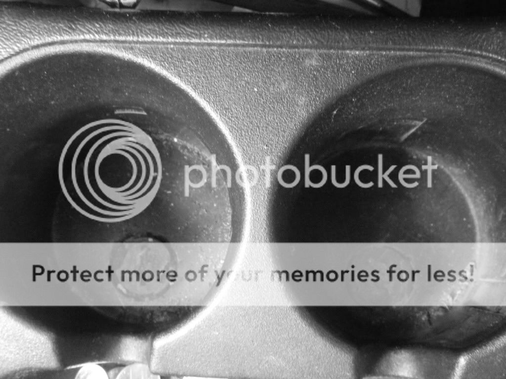

Here's some shots, as you can see, i've already taken a stab at it...and failed.
i believe you just have to turn them 90 degrees and then lift up on the cup holder. then there will be a plate underneath the cup holder that you can remove or fasten you cb to.
I've turned them and they go about 180 degree's if I remember correctly. Regardless, when I did turn them and tried pulling up they wouldn't budge. Maybe I only turn 90 degrees and then pull? Maybe they lock when turned full rotation either way?
yep thats how mine came off turn 90 degrees and lift mine took some pressure though
Turn them 90 degrees and then slide the unit back an inch or so and it should come right out. But you may find a metal box under it . This has something to do with electronics in the truck.
I figured it out. With it locked all the way in one direction, turn it half way between both locks and it will come right up. The restraint module is under there so I just put them back and i'm going to mount it on the transmission hump on the passenger side so I can see the controls and what not. I'll post some pics when i'm done.
