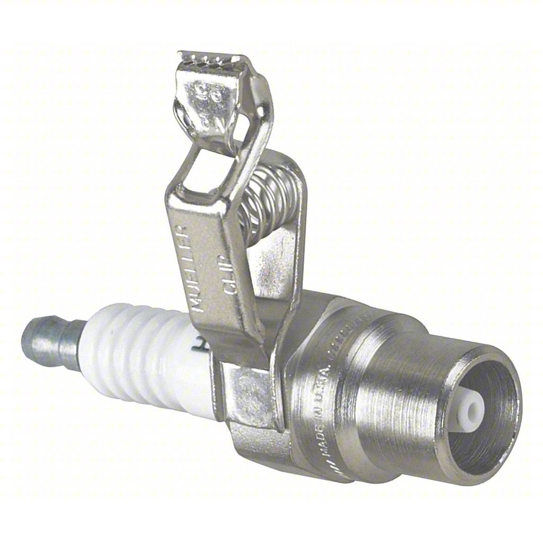

Get one of these spark testers. When it quits... put it on a plug wire and check for spark.

If it doesn't restart after it quits watch the tach as it's cranking. If the primary ignition is working the tach needle will wiggle a little. If it lays there dead you don't have spark.
