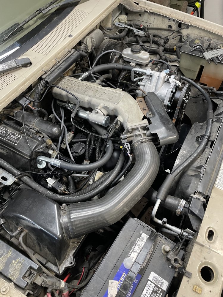

Hi folks,
I’d love some help with this one. None of the other posts I’ve seen have quite address what I’m experiencing.
I just rebuilt and reinstalled the 2.9 in my 1989 bronco II.
I got through initial engine break-in well and now I’m trying to set base timing (10 degrees advanced with spout removed on a warm engine). However, when I removed the spout the engine dies immediately. No stutter, no slow die with cascading rpm, just instantly like the key was turned off.
The engine runs well and sounds good.
The tach gauge in the dash shows 750 to 850 RPM at warm idle, sometimes up to 950. And an auxiliary digital rpm gauge connected to a plug wire was showing more like 1000 RPM, so I don’t know why there is a discrepancy there. But all that is to say that the running RPM is in that range when I pull the spout connector.
The engine is between 200-250°, depending where I am the laser on the block & heads.
the TPS reads 5 v continuous power and goes from 0.86 v steady up to 4.6 v on the throttle test. No flat spots that I can see.
Also, the warm engine will die instantly when I remove the IAC connector.
Using a timing light when the engine is idling around 850, I’m getting 25 degrees before tdc if I’m reading it right. So I think I’m pretty close on timing. Correct?
I’ve pulled codes and gotten 11’s, then pulled later and got “C 63 tp circuit below minimum voltage” so perhaps there is some kind of intermittent connection issue with the TPS, but I don’t know what else to test on the tps or how to.
the IAC is in the 11-13 range. It isn’t dirty, and It opens with 12v battery power is applied to it, and/but it kills engine when I pull the connector.
Thanks for reading!
Dustin

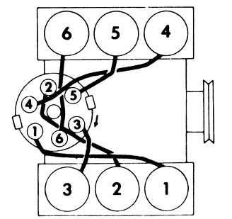

So #1 plug wire goes to the #2 terminal on your cap and the others are out of order too if I understand correctly?
This is how it should be... distributor rotated slightly either way but not wildly different than this. If you have it set up some other way... it's not right... and if it runs, your distributor is stabbed wrong or there was some other mistake made. With that in mind though I guess that still doesn't explain why it dies when the SPOUT is removed.
Yeah the dizzy was stabbed 180 out. Because it was practically impossible to do the first time, I instead rotated the start point of the plug wires on the cap 180 to match. So the # 1 wire is on #5 spot in the diagram, and then continued the firing order around.

TFI is in the normal PS direction, but the plug wires go into the cap with #1 wire in where # 5 goes traditionally. I’ll re-stab the distributor after I get this thing through DEQ emissions testing. I’m just running out of time on my trip permit!
