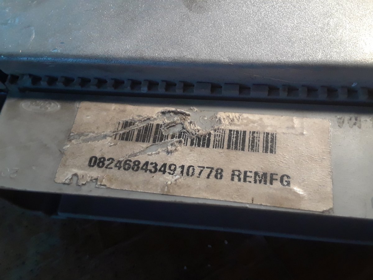

I know that it's a fuel issue. I isolated it down to 5, 3, and 6 not getting the pulse from the computer. I pulled the computer earlier today. There is a sticker on the computer that says it's a remanufactured unit. I assume this to mean it has been replaced before? Tomorrow i will crack it open and have a look. If those capacitors are faulty, all I have to do is buy more and solder them on? Where would I find capacitors? (Can you tell I'm not really a computer guy?)

But if its a "rebuilt" unit it should have new caps already, thats pretty much what "rebuilt" means in these computers, they are the only parts that go bad except the timing crystal, and then circuit board is cleaned

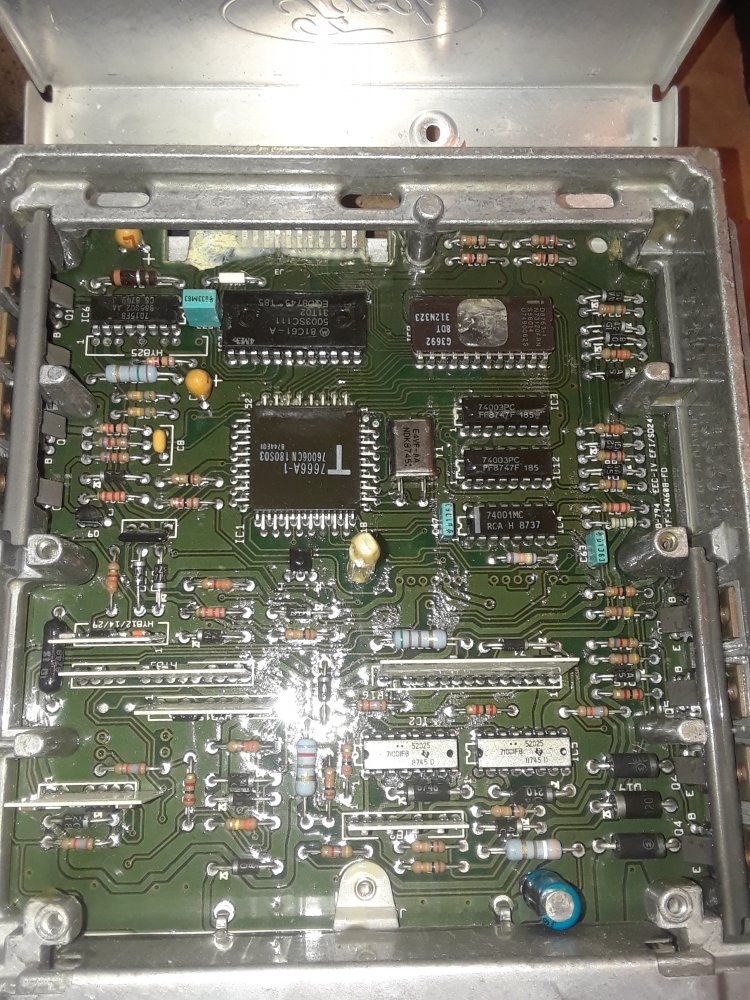

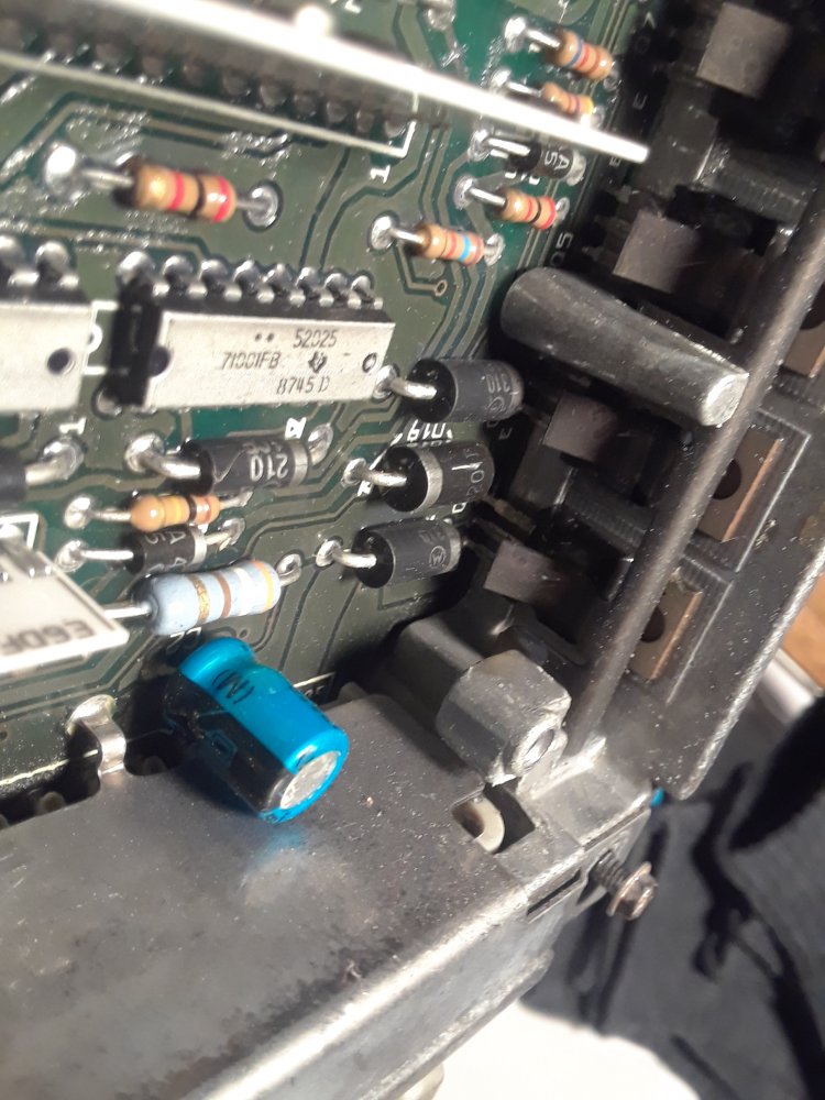

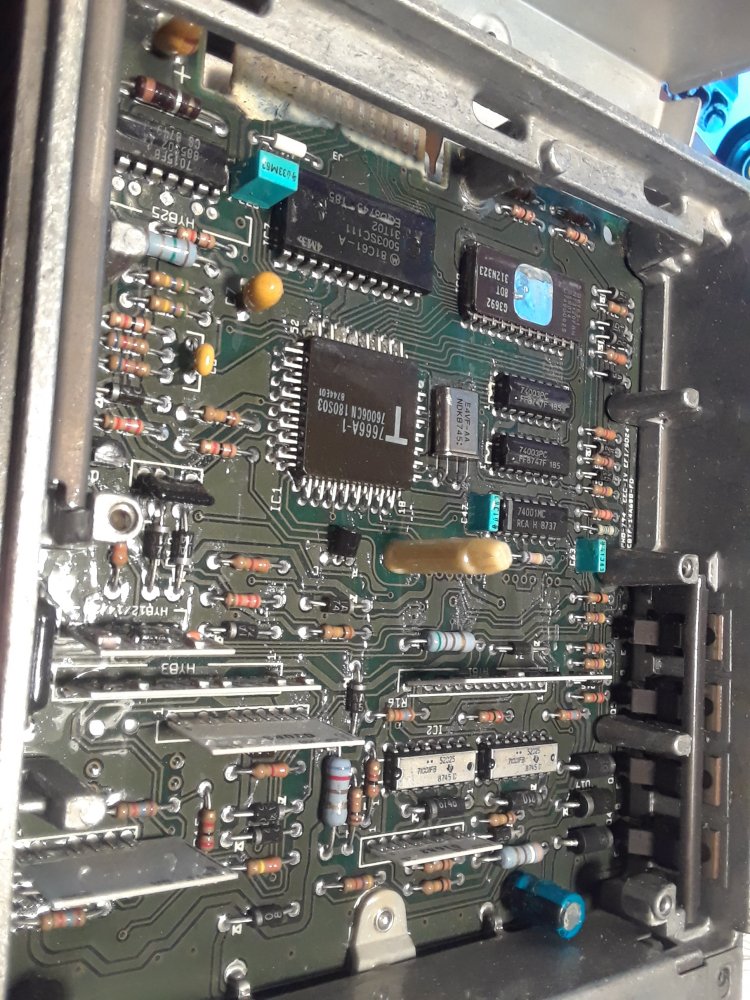

It doesn't look horrible in here. I only see one capacitor and it doesn't look like it was leaking or anything. There is a slight bulge on the side of it however. Is this normal? I mentioned the truck was parked for about 4 years and I live in the wet and rainy southeast. I know the truck has some problems keeping dry because even if it hasn't rained the carpet below the floor mat is still wet to the touch. How sensitive are these things to water?

I can't say I ever saw anyone using "film" capacitors in these before, the 3 blue rectangle units, but no they shouldn't have a bulge
Yes, moisture/humidity effects these computers alot, which was why they were moved to the engine bay, as odd as it sounds the engine bay has less moisture/humidity than inside the cab, lol
But as long as the board is clean that shouldn't be an issue
Bulges are not good. Any computer that seems to be giving problems, I take the cover off and look for bulges / goo on capacitors. And note if there is any 'ozone' smell. If any of that is true, there's a hardware issue.
I took the best picture of it I could. The round capacitor has some slight residue on the top. Those rectangle capacitors, do they fail internally? What is my best course of action from here?

Usually, the 'goo' I see leaking out of computer capacitors is brown. And the tops are invariably bulged out. That one, I can't say for sure is bad.
So what do y'all think is the best thing for me to do? Do you think it could be a programming issue? Should I try the cheaper thing first and attempt to replace the capacitors and see if that works? Or just order a new computer and be done with it? I have a few friends who are far more electronically inclined than I am. Also, that residue on the circular capacitor appears to be green/clear. It really isn't much at all and it could be just from the glue they used on the casing.
